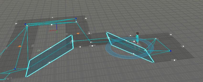

read through it and made the changes, i appears when i try to make them go up stairs to a second storey they don’t follow it any advise on this or is it the same issue?
if you start simulation and then click on the “Show Navigation Mesh” button in transport controller properites, is your navigation mesh there too? Maybe share a picture of what it looks like.
This is the navigation mesh
do you have pathways between the levels as a connection?
as in my picture, marked:
Yeah there is a small pathway as a connection between levels
put this stairway in list of excluded obstacles:
That fixed the issue for one of the operators, other two are still not following but your advice did help thank you
