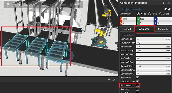

Sorry for the late reply, uncheck these conveyor’s Advanced::RetainOffset should work.
Thank you so much for the response.
