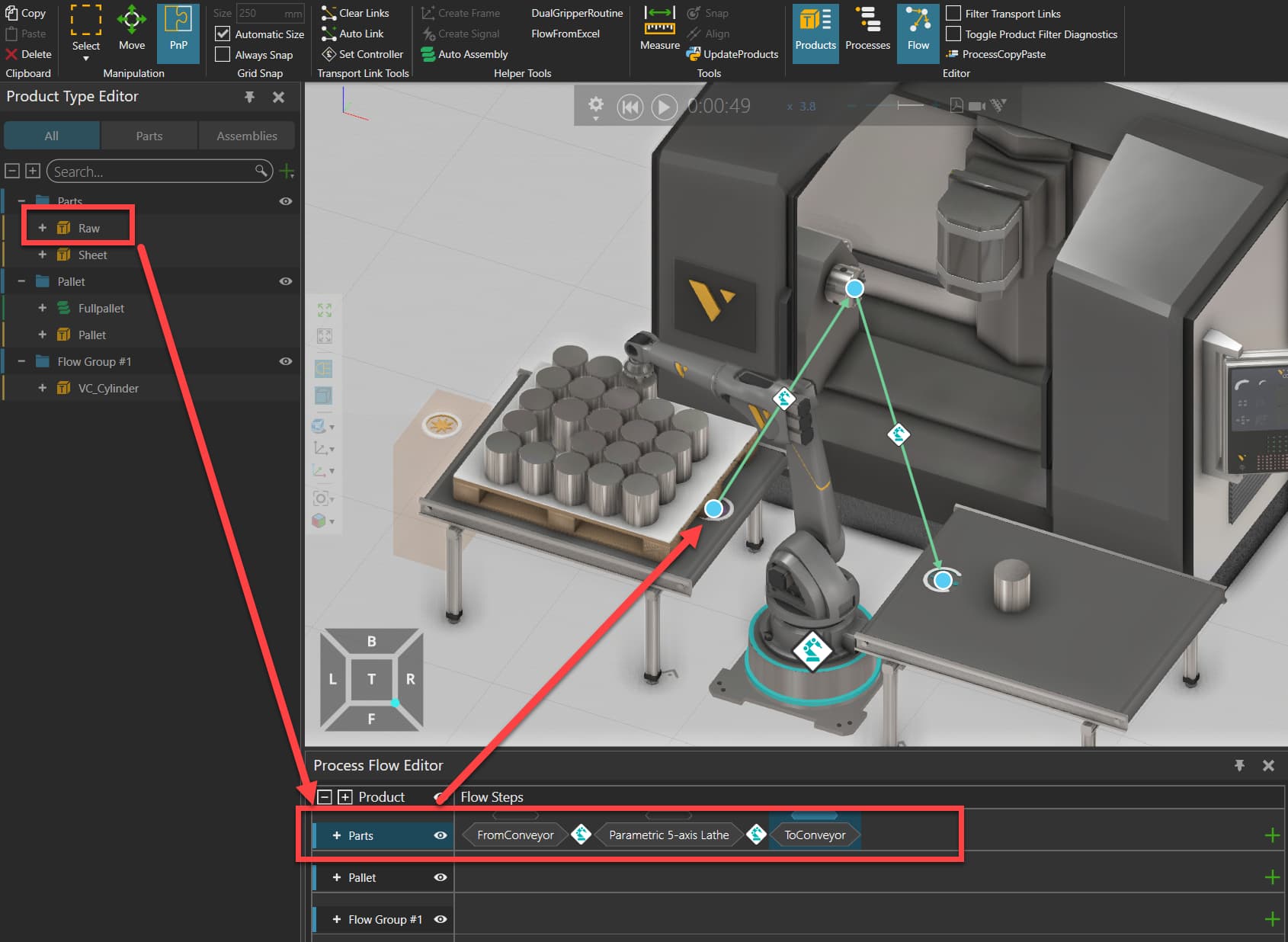

I am learning the VC software. After watching the necessary prerequisites I did the basic work with assembly and created a pallet of parts.
Now when I take the same to the machine, the robot is not picking the part and rather the entire assembly. I tried filter, get assembly statement etc., still the problem persists.

you are working in the wrong Flow Group. The parts are in the Flow Group “Parts”, so you need to configure your flow in there, for the robot to pick the parts.
After a while, if the robot stops, it’s because the parts are out of reach
