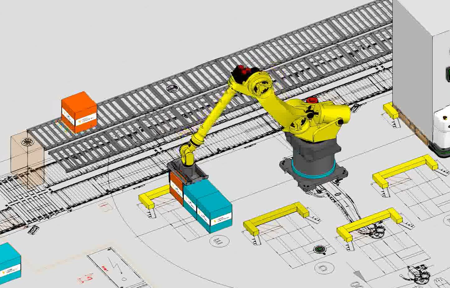

Hello there, I’m trying to palletise more SKUs coming from one conveyor in the given distributions. I did create unique boxes, pallet assemblies,.. but I am doing something wrong.
Can you please help me?
In the video, I want to put blue boxes on position E and orange on position D.
Thanks a lot

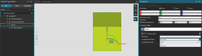

The video still doesn’t load, but i think this might be the problem; In your assemblies, click on the product filter, and filter for the correct product in each assembly. Now it will only transport in that specific product:
Hello Jesper,
thanks for the idea. Now its working using filter and Trasport patter in and I can live with that.
