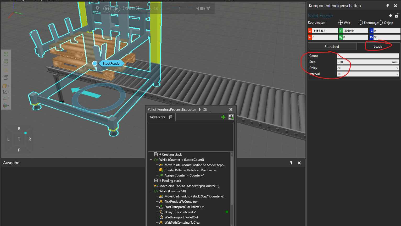

Pallet Feeder is how to achieve a linear array of many Pallets
Pallet Feeder is how to achieve a linear array of many Pallets, I do not see the script file about the array
Hi
Do you use the pallet feeder from category “PM Warehousing”?
In this pallet feeder you have the tab “Stack where you can define count and step”.
the stack is then created in the process routine “Stack feeder”.
