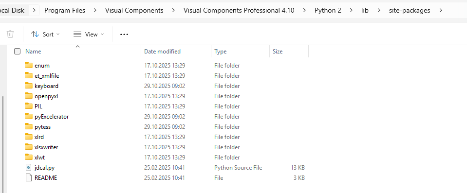

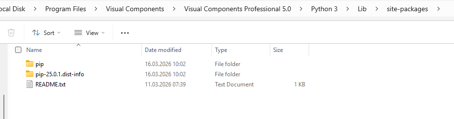

How to work with external Python libraries in 5.0? I use openpyxl for my use case. It used to work with 4.10 as openpyxl was pre-installed.
VC 4.10 Py2 site-packages:
VC 5.0 Py3 site-packages:
Unfortunately, I do not have admin rights and can not install it myself at this location.
