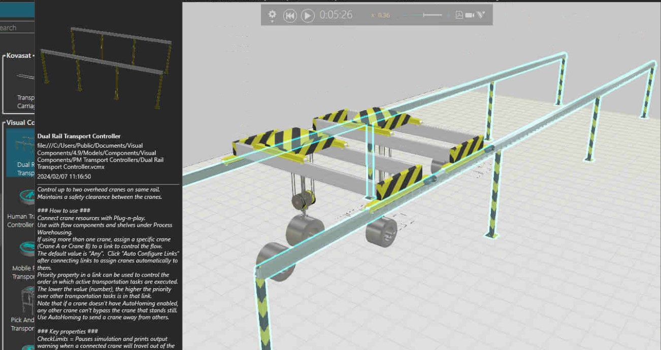

I am looking to model a Coil Steel warehouse that hosts multiple cranes in a single continuous long double rail, like hundreds of meters long and with 6 cranes that are able to work in overlapping zones.
The current component for the double rail controller only allows for two cranes to be connected, respect their boundaries and safety clearances. The waiting time from overlapping working zones is something that I want to consider because it has a big impact in productivity. I want to know if you guys have any ideas on how to model more than 2 cranes at this moment.

Some reference picture for the ones that have not used the Double rail controller.
