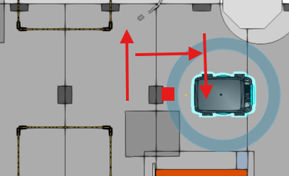

Thank you Tilma, also we will be using an AMR with omni capabilities. Is there a way we can control the navigation of the AMR so that in a certain pathway - it moves sideways instead of straight?
What I mean is that here to avoid a column, is there a way I could force it to go left then forward and then right - in the same AGV orientation?
I think it’s difficult with the PM function that’s basically provided, and it might be possible with the use of the Mission Controller.
@rprasann At present, VC corresponds to the MR module, without the AMR module, so using MR to implement AMR functionality may not be possible or difficult!
