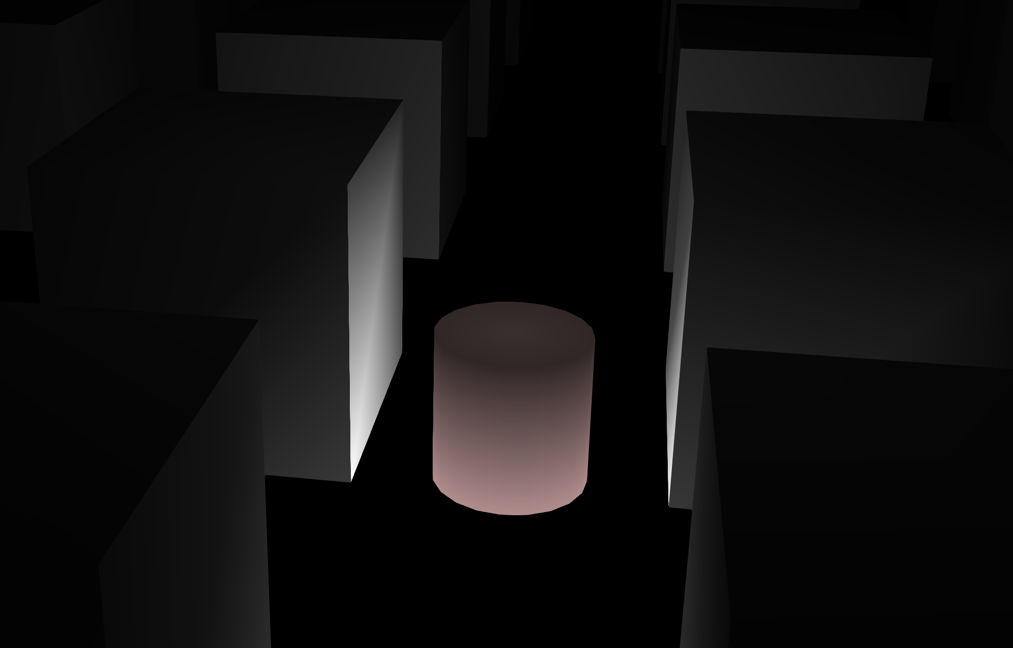

Here is quick example, and note that depending on light type you might not need to set certain properties. I turned off the 3 directional lights as well in the scene to give Minecraft, Silent Hill vibes. Clean up the 5-min code as needed.

Get creativity with the component material too. I prefer salmon or pink gold if you are feeling edgy.
For attachment, updating the light position will take care of that for you. (Sorry, no idea if mp4 will play here these days)
