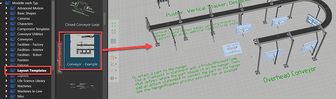

Hi @BAD, I think you’ll find the “Overhead Conveyor” (in the eCatalog → Conveyors) easier to use in this case.
There is also an example on how to use it in the Layout Templates:
