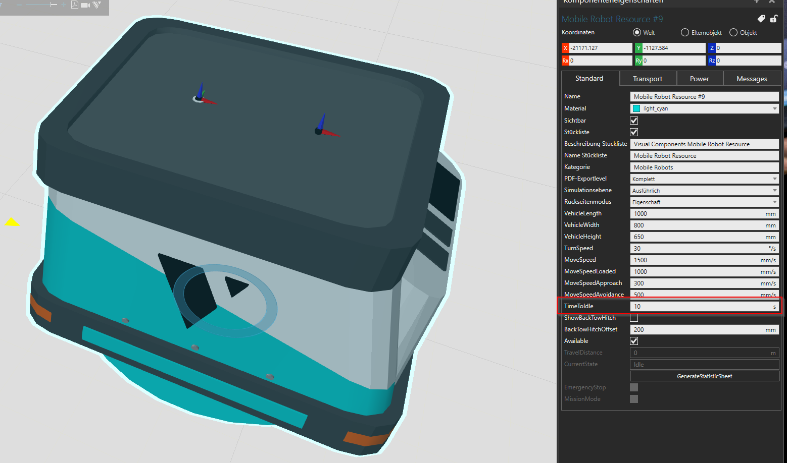

After the Mobile Robot delivers the product to the Sink Process in the Process Flow, it does not immediately return to the Idle Location but stays still. Is there a way to make it return to the Idle Location right after completing all Flow Process operations?
Hi hooyoung,
you can set the TimeToIdle time to 0s. After that the mobile robot can directly move to the idle position if no new task is available.
br
It turned out to be an easier problem than I thought.. Thank you. bro
