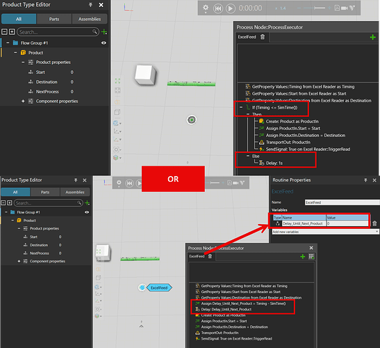

Hi, for the second approach, with the Excel Reader, you can use “SimTime()” to get the actual time and wait until it’s time to create a new product.
One solution would be to use an If-loop in which you check if Timing <= SimTime()" . If yes you can create the product, if not wait 1s for example.
The other solution would be to add a Real-Property to the process to calculate the remaining time before you need to create a new product –> Delay = Timing - SimTime(). And then use a Delay in which you use this property as Expression.

The product property NextProcess was just a test to transport the product to the correct Machine process using the property filters in TransportIn (NextProcess = Start at the begining, and after having been processed once, NextProcess = Destination). It might also be possible to use the GetFlowStep + SetNextFlowStep statements to adjust the flow for each product.
The statement SendSignal is used with the ExcelReader to read the next row of the table by triggering the signal “TriggerRead”.

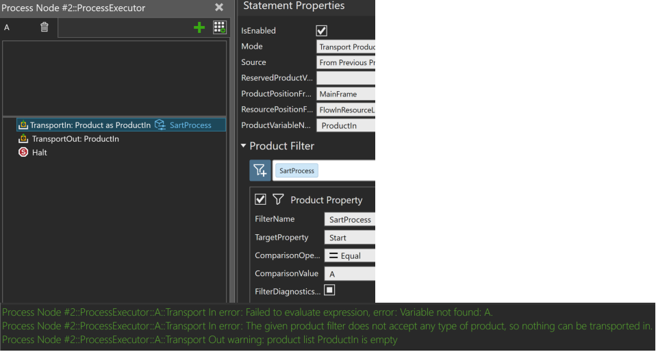

Hello Tilma
As I tried to duplicate your layout, it shows this error in the filter. Do you know why it is?

The property Start is a string, so in ComparisonValue you need to write “A" not just A
Thank you, Tilma, now it works.
