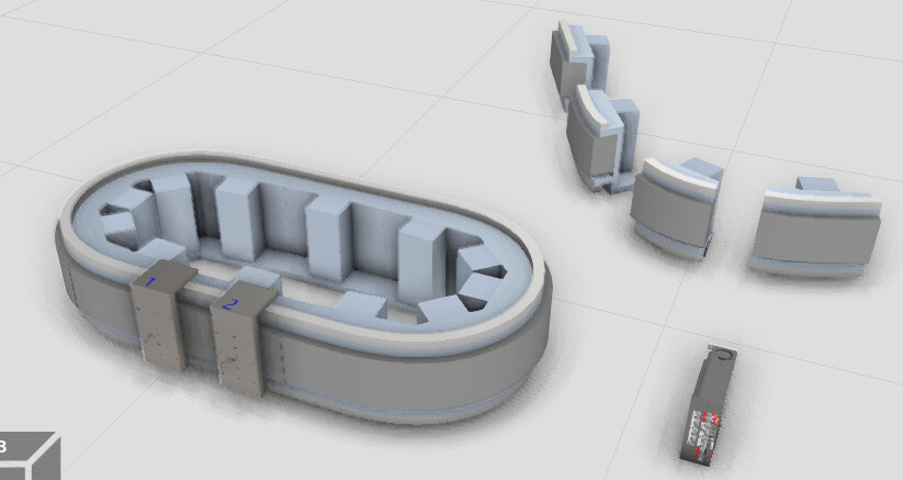

This includes 4 different track modules (a 45deg curve module, two 22,5deg linear-curve modules and a straight module), a carrier, and a controller used to configure the system.

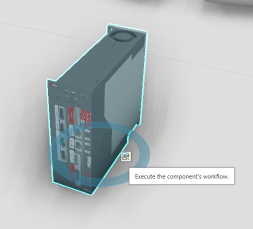

Get started by clicking the Workflow icon in the Controller component, when it is selected. Also component metadata has extensive instructions.
In Simulation mode, carriers are products traveling on conveyor paths.
In External Controller mode, carriers are static components whose custom joint is moved according to the expression that Controller configured for the track configuration. They can be used with connectivity plugins to subscribe carrier positions.
