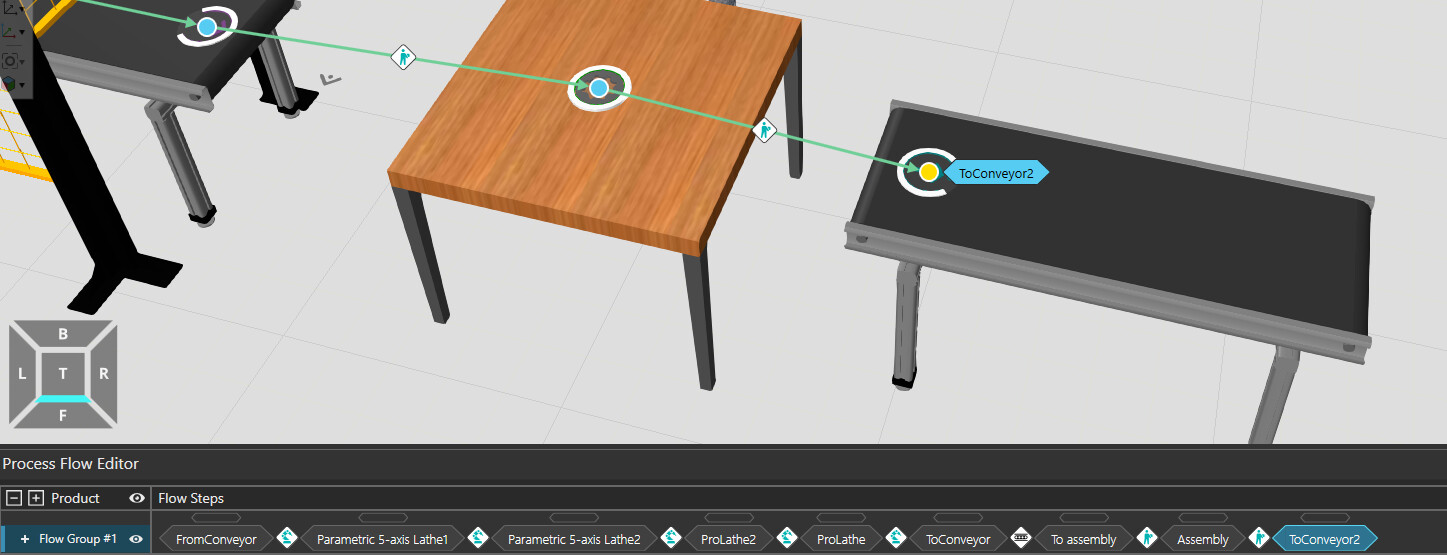

  1. Please check the product filters in TransportIn statements of process “Assembly” and change the “AcceptedProductTypes” so that one statement accepts one product
  2. Using Processes editor, rename the process “ToConveyor” after the assembly process so that it has a unique name, for example “ToConveyor2”.
  3. Move the transportation from “Assembly” to “ToConveyor2” to flow group #1, as the product type “Piston” belongs to flow group #1.
After these changes, the simulation runs as it should.
