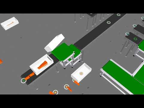

I’ve tried making an assembly out of physics object which didnt work and I´ve tried using a physic converter on a conveyor with hilarious yet negative results which you can see here https://www.youtube.com/watch?v=RIBb5LEcpRY

@Este@TSy thank you for replying. After some trials I’ve figured out that a way to make assemblies work with physics. You were right, as long as the physics colliders don’t overlap it should do just fine.
Rendered two examples , one without a box that works and one that is boxed in and freaks out.
I’m happy its been a bit cleared out but also a bit sad that I cant have them inside each other. As I would like to make a scenario in which for example a product is put inside a box, then the box is closed up and given physics properties so that physics pushers could interact with it.
Thanks again for the replies, they helped in clearing things out when I was testing.
