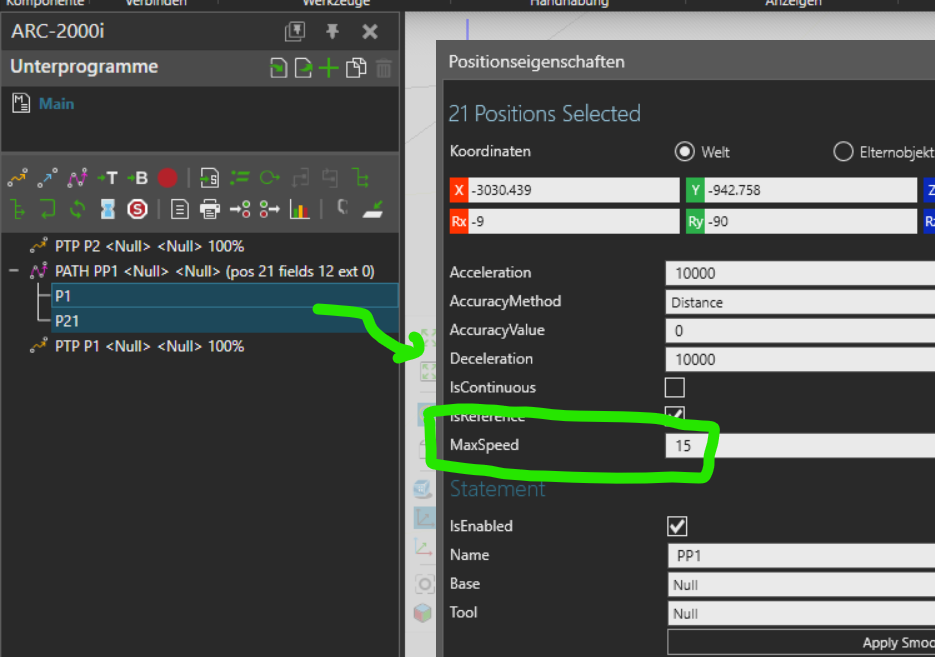

Given that you referred to the robot path, are you talking about the path statement and wanting to slow down the movement between points?
If so, you can select the first and last point of this created path-statement (using the Shift key on your keyboard to select all points in between), and then adjust the speed in the properties on the right side. That should work?

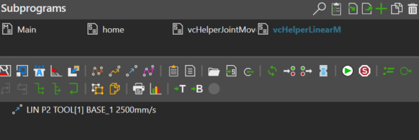

The program tab:

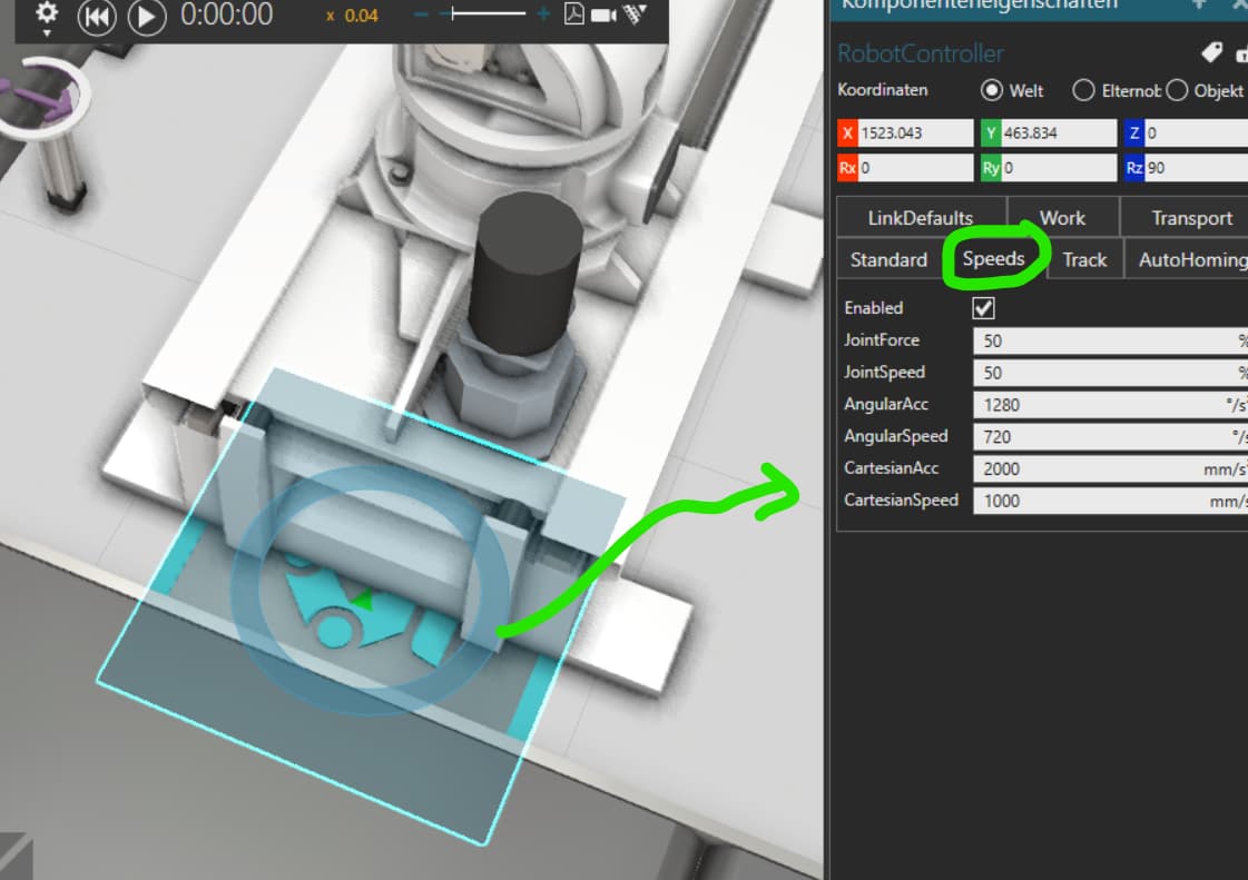

Note that in vcHelperJointMove and LinearMove routines, points are automatically written/overwritten by the robot transport controller. If you want to change the speeds, use the component properties of the controller:
Alternatively, you can record the robot routine and execute this robot program. More:
