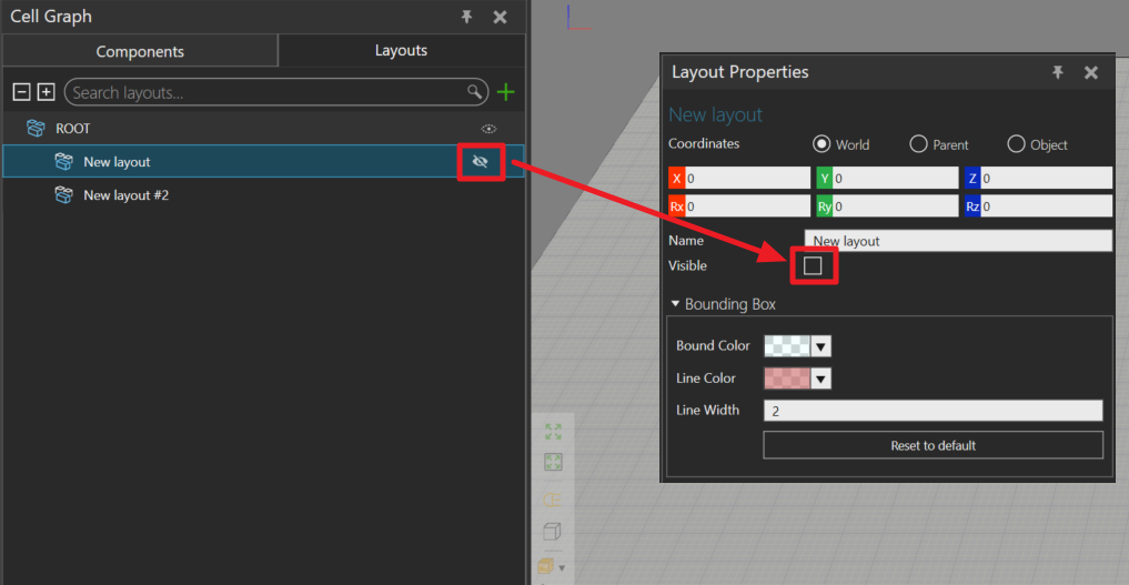

If you look at Cell Graph, there are Layouts. Is there a Python API that can enable Visible in New layout as shown in the attached picture?
I would like to place multiple layouts and link them with Python API for only the layout that is needed depending on the situation to enable Visible.
Best regards,
sim.World.Layouts[0].Visible = False
Thank you for your reply, it helped me a lot.
