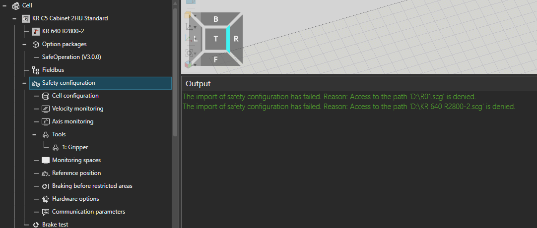

I’m trying to import the configuration,but it has always failed.How about solving this problem?
Check file permissions and ensure the software has access rights to the paths. Run the application with administrator privileges or adjust folder/file access settings.

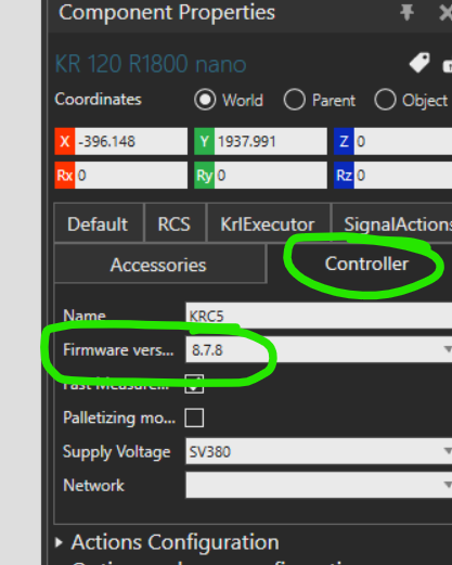

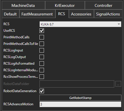

Can you check tab controller in robot component properties:
Even though the version numbers may look identical, they might differ internally, maybe both might show ‘8.7’, but have different build numbers or patch levels that affect compatibility.
Thank you very much. The problem has been solved.
