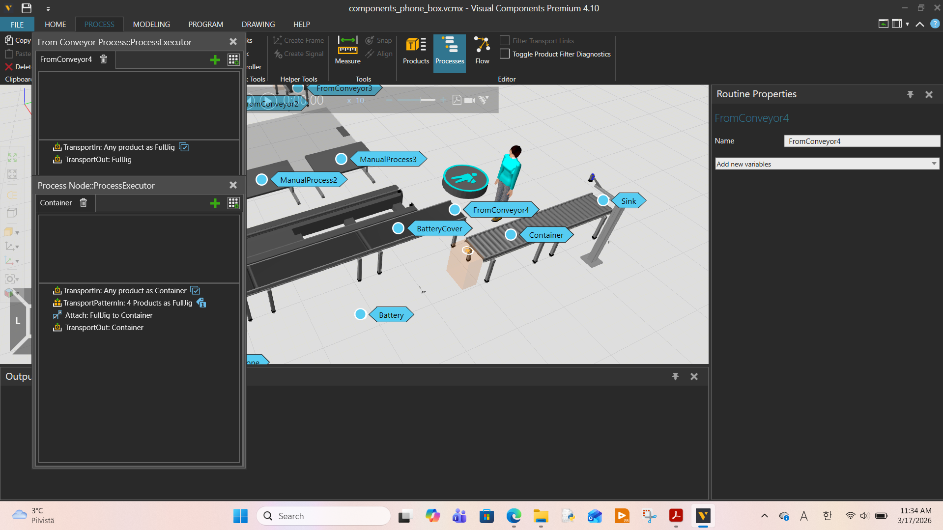

I am encountering an issue with the human resource responsible for transporting the jig.
When the process node is removed and only the jig is transported, the human resource moves correctly and delivers the jig. However, when the jig contains the fully assembled components, the human resource does not move and remains idle. I have tried adjusting several settings but have not been able to identify the cause of this behavior.

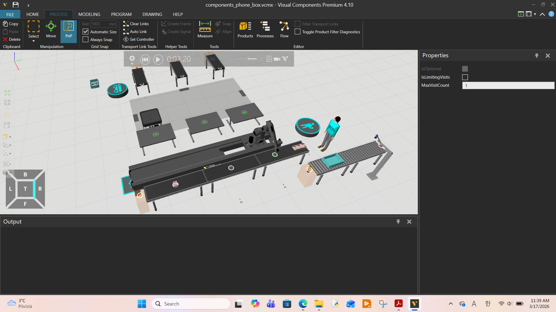

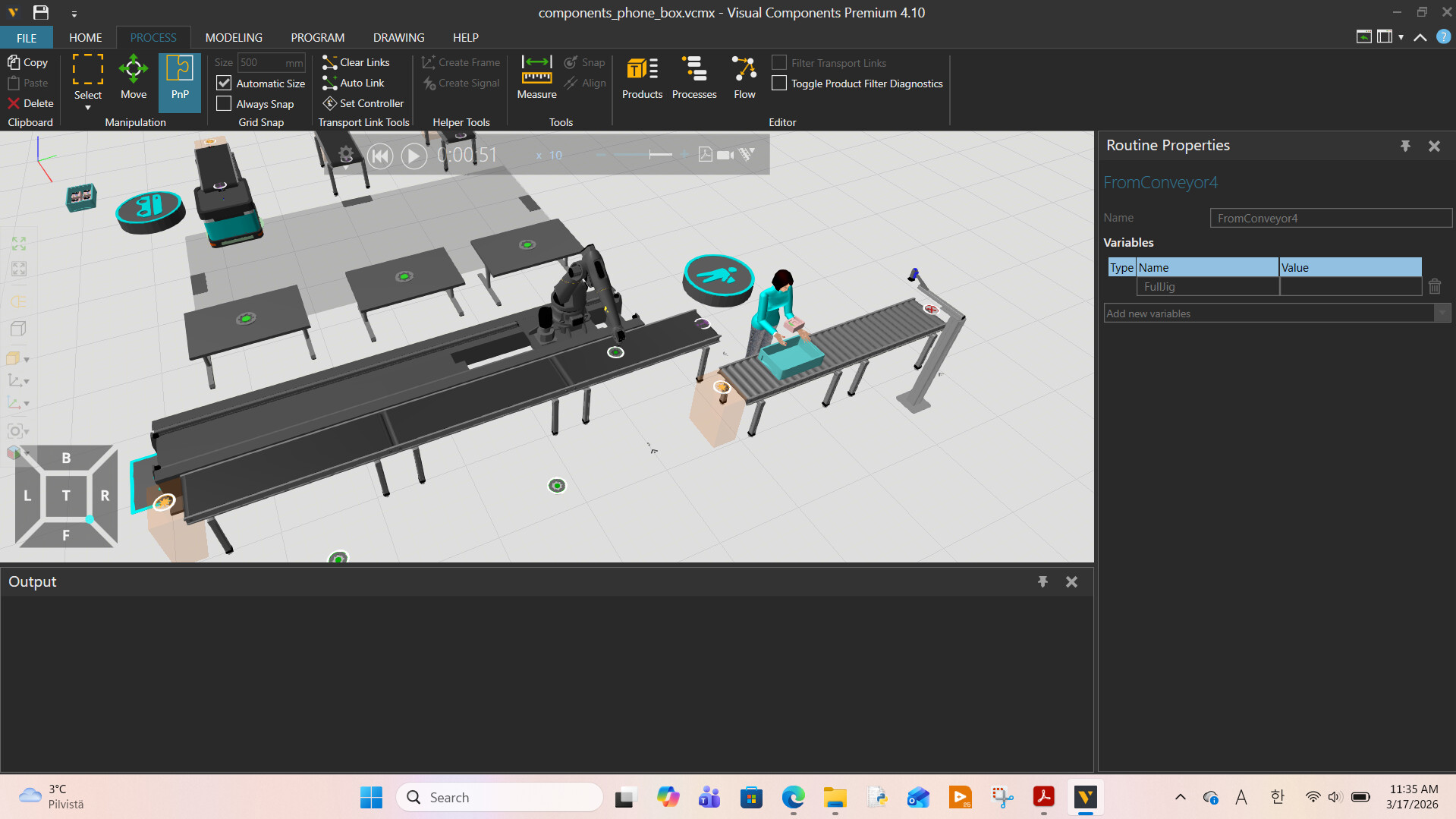

To clarify the situation, I have attached two screenshots:
  1. The version where the process node is removed from the conveyor for comparison.
  2. The version with the completed assembly process.

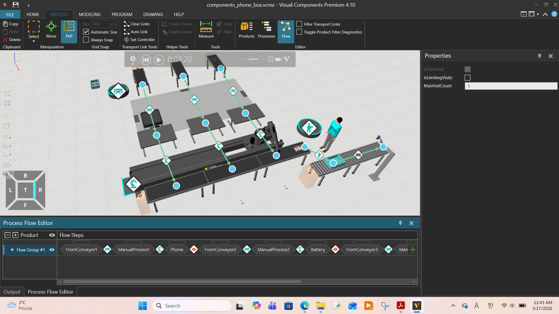

3.Flow
