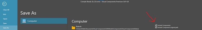

It looks like you have custom CAD/Components there that you have not saved within the file (only PATH is saved). This makes it impossible to determine what is going on with the layout as it, unfortunately, does nothing when I click on play simulaiton.
You need to save the components in the file itself, and you can do this from the file backstage:
As for your problem that I can’t really debug right now due to the VCID missing, I recommend that you go through the academy, and specifically the Assembly side of the Process Modelling:
