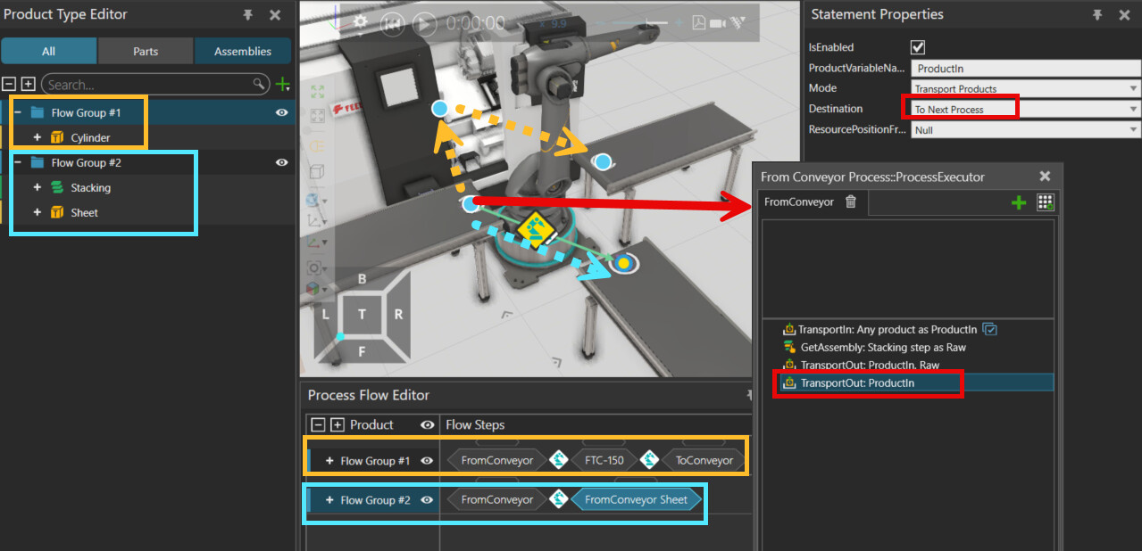

Dear all, I am doing a work in Premium 4.8 with assembly feed to a CNC robot cell. I want the base sheet to be removed separately into another conveyor. I couldn’t do it. The file has been attached herewith. Please guide me.

you also need a Flow for the sheet. Add a new Flow Group for the Sheet + Assembly, and then define the Flow of this flow group.
Don’t forget to set correctly the TransportIn Source and TransportOut Destination (usually when it comes from or goes to a conveyor it’s “From/To Component Container”, and when it is transported by the robot or another resource “From previous process/To next Process”)
