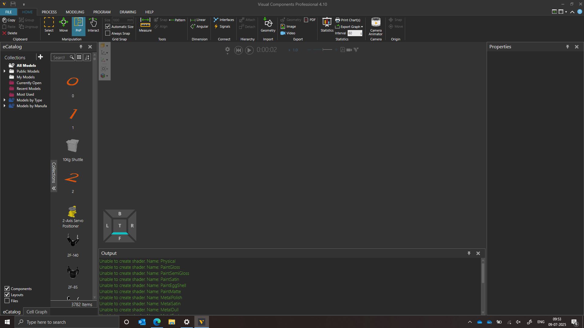

I am facing an issue that my 3D visualizer is not starting. In output window i getting errors. Earlier it was working fine on my laptop. I have used software rendering, then also i am not able to get the 3d Visualizer. For reference i am attaching the Image. Please Support.
The error which i am getting in output windows are listed below.
Unable to create shader. Name: Physical
Unable to create shader. Name: PaintGloss
Unable to create shader. Name: PaintSemiGloss
Unable to create shader. Name: PaintSatin
Unable to create shader. Name: PaintEggShell
Unable to create shader. Name: PaintMatte
Unable to create shader. Name: MetalPolish
Unable to create shader. Name: MetalSatin
Unable to create shader. Name: MetalDull
Unable to create shader. Name: MetalCast
Unable to create shader. Name: PlasticGloss
Unable to create shader. Name: PlasticSatin
Unable to create shader. Name: PlasticMatte
Unable to create shader. Name: GlassClear
Unable to create shader. Name: GlassSafety
Unable to create shader. Name: GlassSmoke
Unable to create shader. Name: GlassMatte
Unable to create shader. Name: PaintApplication
Unable to create shader. Name: SimpleShader
The Problem has been resolved. Anybody want answer then post your comment. I will share the way how to handle this.
Please share your solution
@luhan This Issue is directly linked to Graphic Card. I have 2 graphic options on my laptop. And this Version of visual component was earlier running on Integrated Graphic card. But due to some setting change it has been changed to Nvidia Graphic card (Which was not updated or having some issue). First, I uninstalled the Virtual components all software and then i reinstalled it and make the setting to use integrated card only. Then it started running okay.
