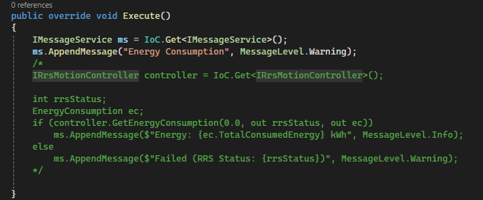

I am trying to create an interface of type IRrsMotionController. Does anyone know how to instance it properly?
I get an error when I try the following code:
IRrsMotionController controller = IoC.GetIRrsMotionController();
Thanks in advance.
Thanks in advance.
private IRrsMotionController _motion;
_motion = IoC.Get<IRrsMotionController>();
Thanks for the response.
But that was the original line i meant to paste. For some reason the code between the “greater than” symbols got deleted.
Do you have any other suggestions?
IRrsMotionController is only available in Visual Components Premium or KUKA.Sim, what version are you using?
I’m using KUKA.Sim 4.3
