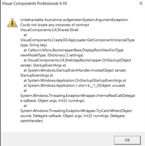

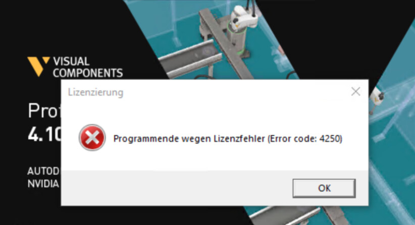

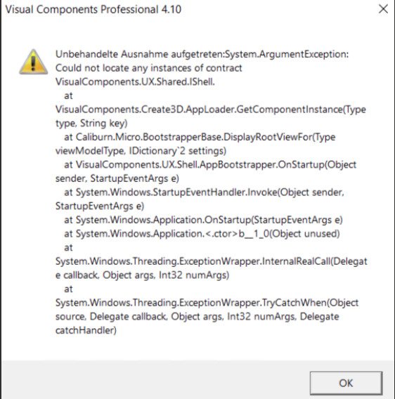

Hello @keke , I am stuck in accessing the VC 4.10 using my remote desktop.
It would be great help if you could guide me on the same. I am using a floating license & checked there is not any restrictions from the firewall side as well as have tried reinstalling the VC & restarting the remote desktop.
Below are the errors which are popping up:
The licensing issues go to the support channel, please contact them. Please also note how long it has been since the last reply, “necroing” (raising an old and dead thread back to the living) should generally be avoided.
