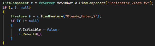

Hy @juergenb,
what Version of VC are you using?
On VC 4.10.2 this worked for me and Schiegetor is a cloned by same stuff you do, the only difference there was that second param was true…
The orginal stayed visible and in the clone it was invisible!
Regards
