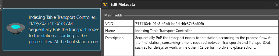

Indexing table transport controller is online now, sequentially PnP the transport nodes to the station according to the process flow, simple statements and intuitive transport links.
Indexing table TC

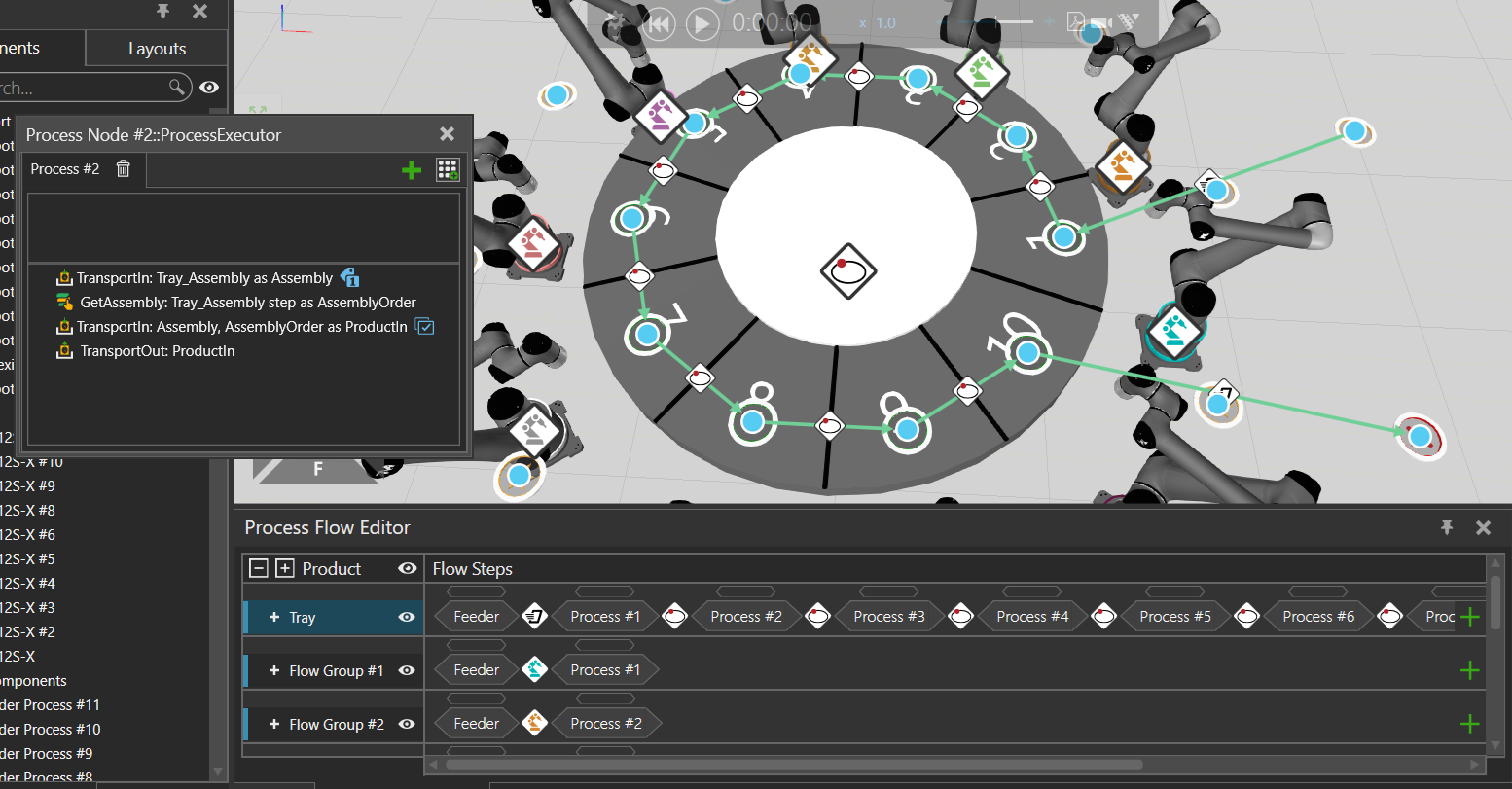

Hi, i made the same but the table dont rotate… can you please help?
Looks like you have a lot of flow groups. You could try to remove any unnecessary flow groups ,and ensure that your products and transport links are defined in the correct group.

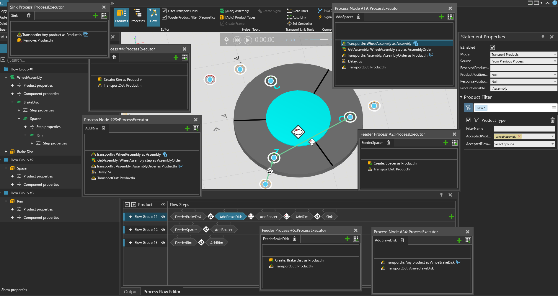

Also please consume simulation time at the final station.

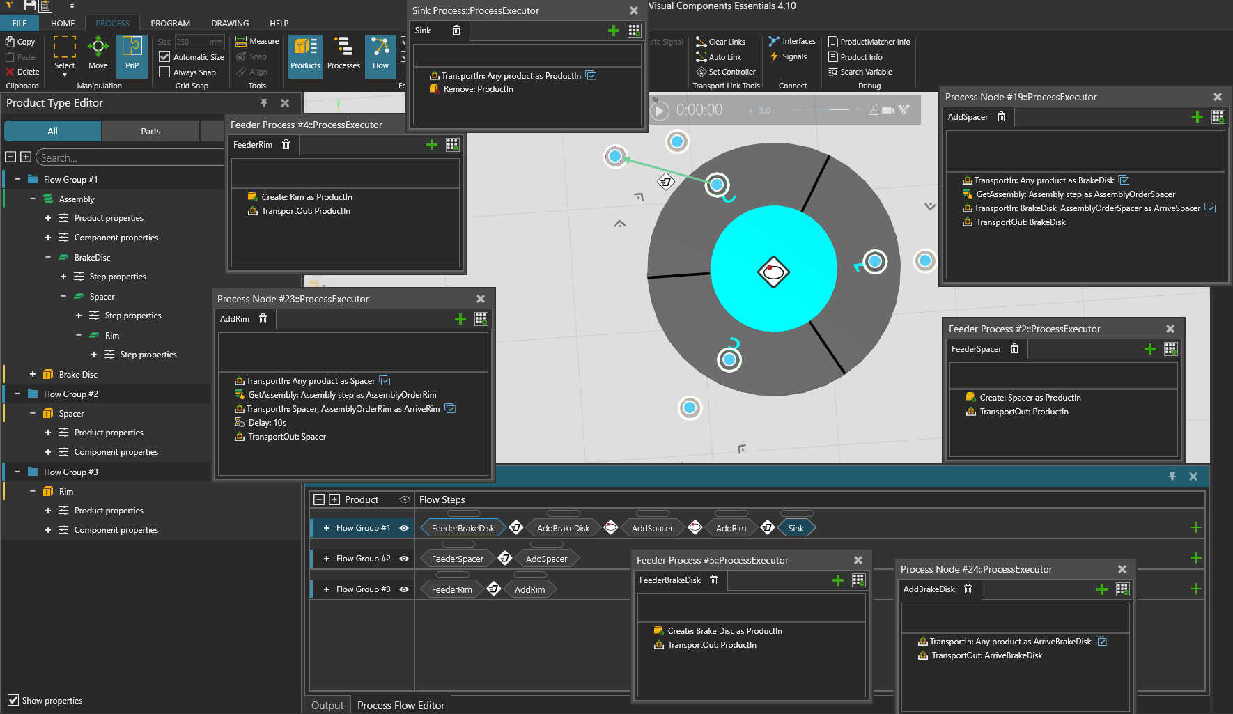

Hi add delay of 10s in last station, I use 3 flow grups one for each station…
I think it might not like that your first step in on the Station 3 and not the Station 1. I tested both way, it didn’t work when the product was coming in station 3 first, but when I just rotated my processes to make it start on Station 1, it worked
Hi, thank you for your help, I change first step to station 1 , it rotates but the parts go all at the sdame time the station 2 and 3 dont wait for previuos process… I think properties for the transportIn in station 2 and 3.. are not correct…

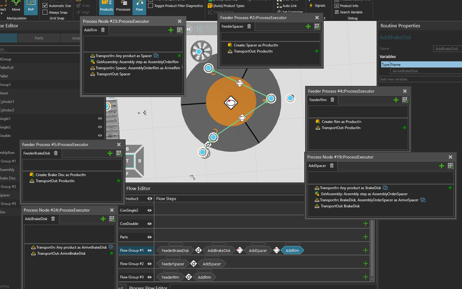

Hi, can you please send one example with index table?

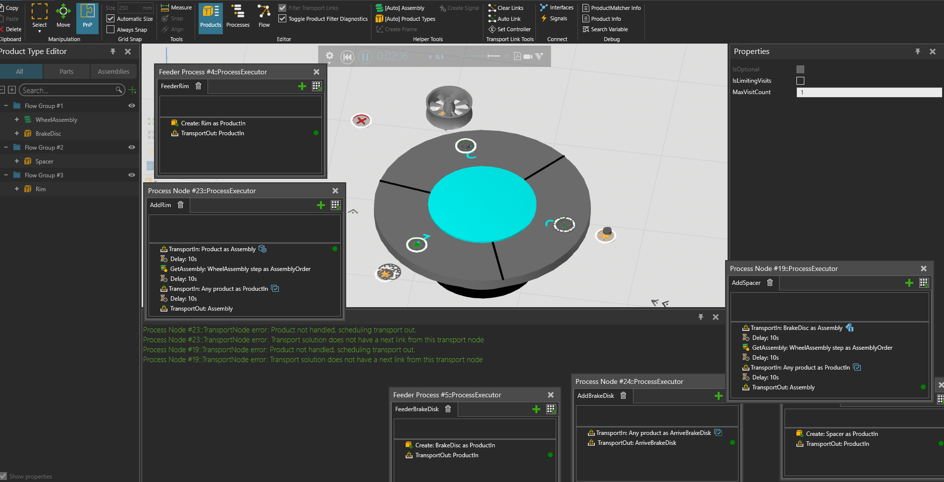

I still have issues, now the position one place the part, second position wait to rotate first part and then feed the part to assembly, then the table rotate to position 3 and stops:
