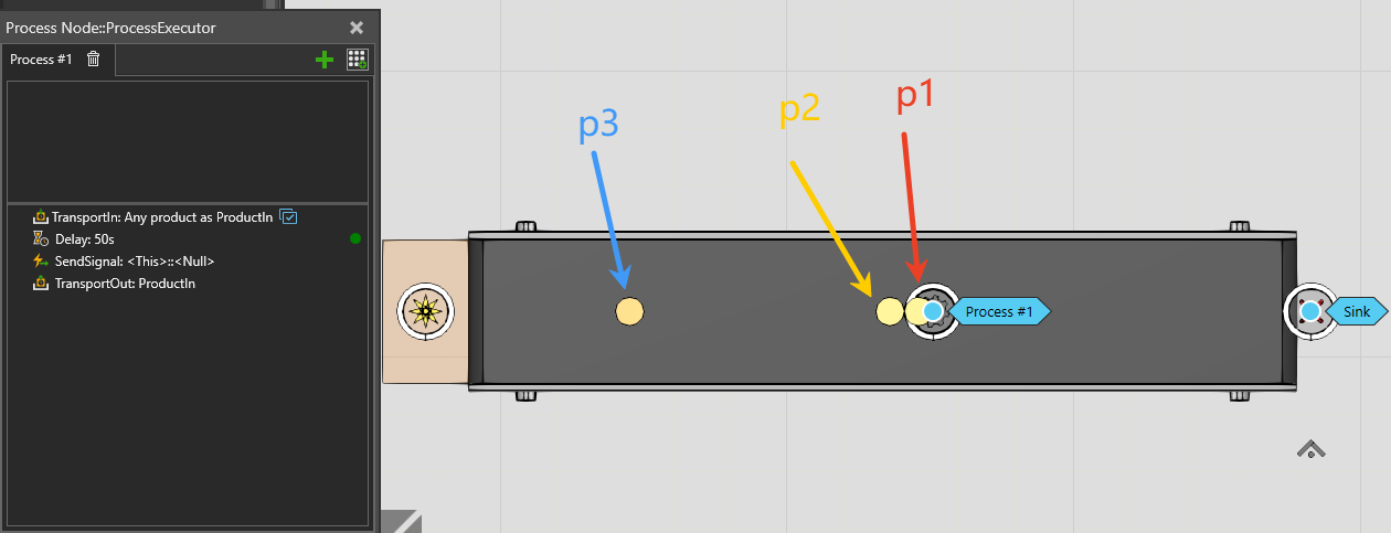

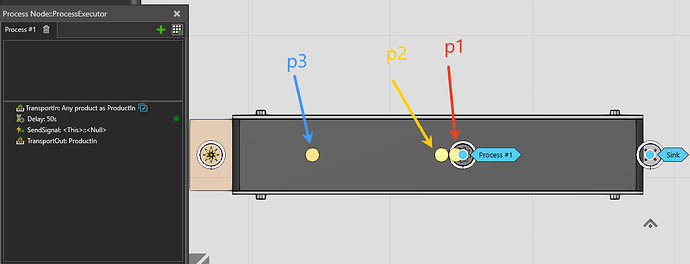

1):Under normal circumstances, each product sends a signal after entering Process 1 for 50 seconds, but subsequent products will block after P1 during this 50 second period, such as P2. I want each product to enter Process 1 freely without any blockage and then send a signal after they enter Process 1 for 50 seconds.
2):In other words, if there is no blockage, assuming that p1, p2, and p3 arrive at Process1 5s, 7s, and 20s after the start of the simulation, I will receive signals at 55s, 57s, and 70s, respectively.
I don’t know how to implement this idea, so I would like to seek your help.

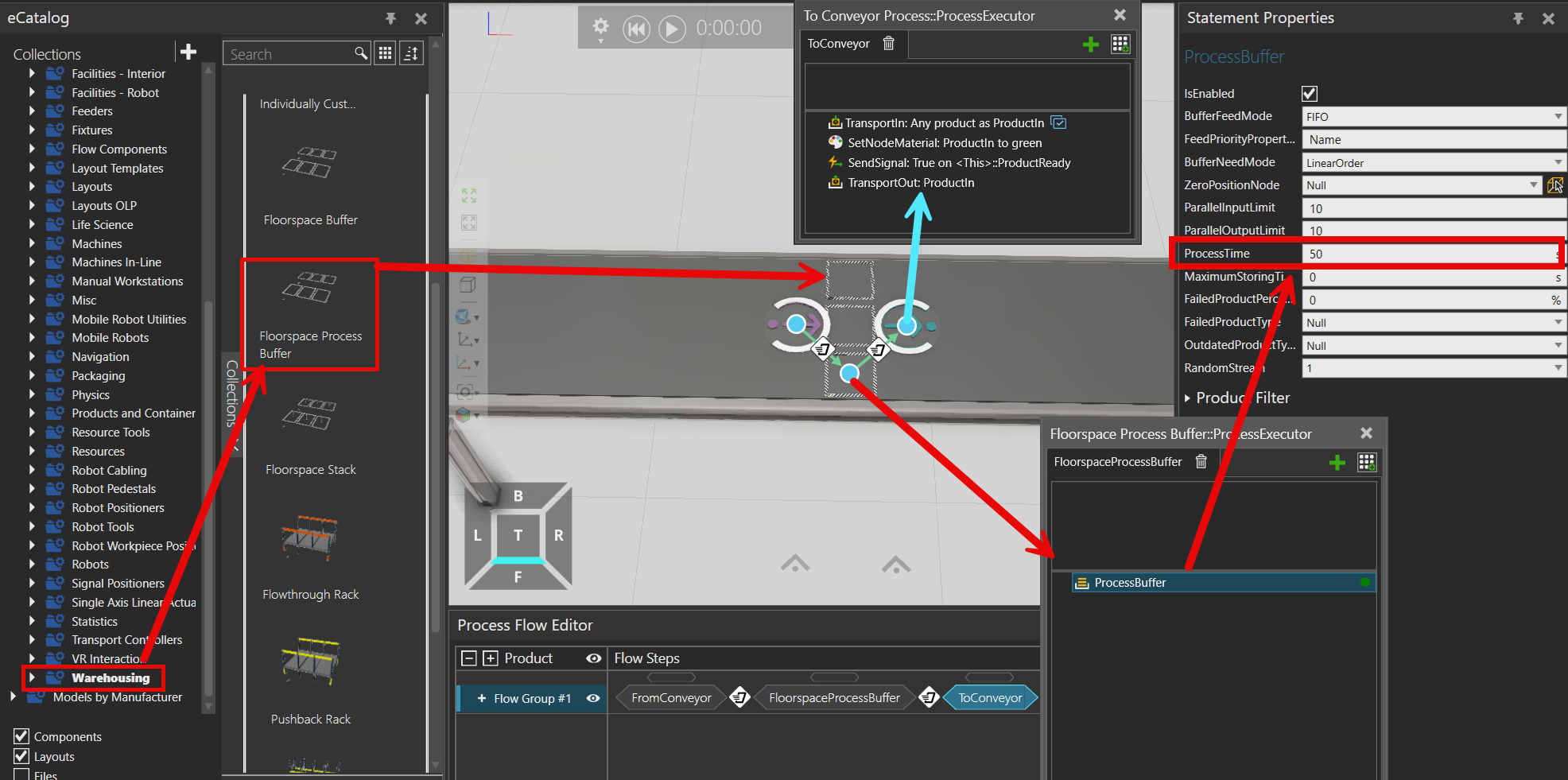

If you want to be able to have several products in the process at the same time, the easiest way would be to use a Buffer. For example the “Floorspace Process Buffer” under “Warehousing” in the eCat has a property “ProcessTime” which you could use to define how long the products are staying in the process. You can make the slots of this components smaller and put it on top of the conveyor, then with a From Conveyor and a To Conveyor process have the products arrive and leave this buffer using an Interpolating Transport with a small TransportingTime. In the ToConveyor Process you can add your signal.
