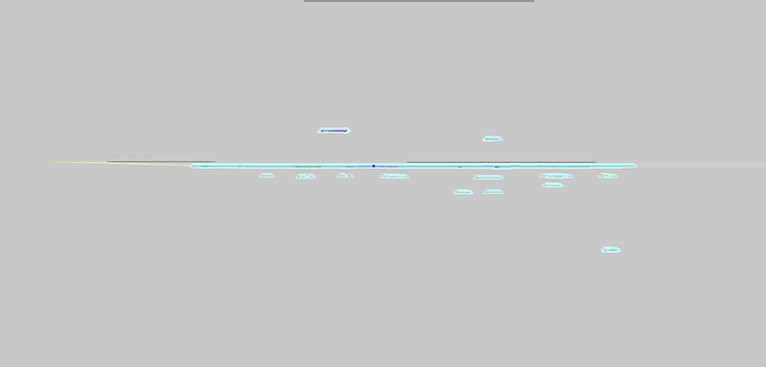

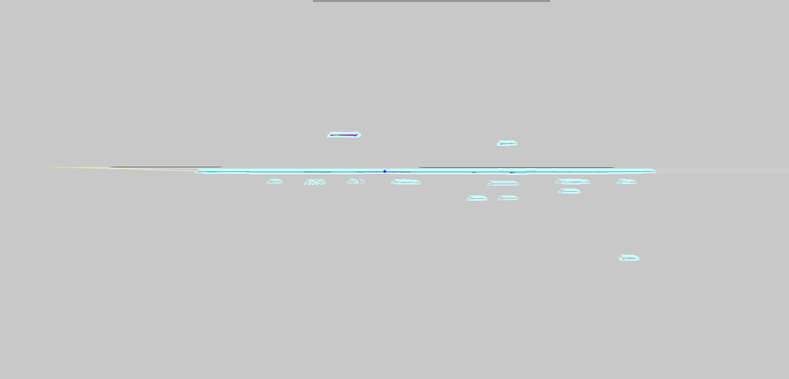

The capture is right orthographic view.Obviously the content is divided into multiple levels, not in the same plane.
