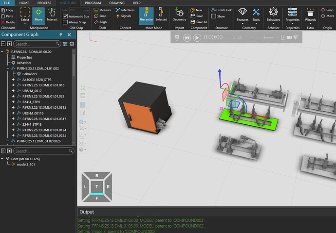

Previously, when I imported a standard STP file, the CAD tree in the “MODELING” tab looked like this, as shown in the image below.

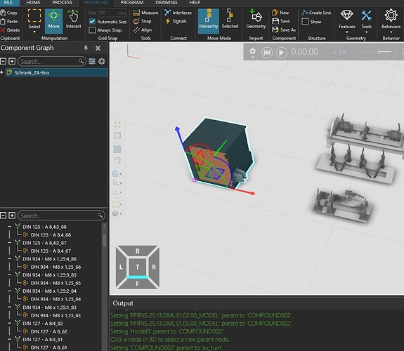

But now, when I import a normal STEP file, it appears to be broken down into links. This makes it very difficult for me to intervene. as shown in the image below
I reinstalled it and deleted the ‘temp’ files, but it still didn’t fix the problem.

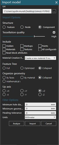

Is the problem with these settings?
Thank you in advance for your help.
It’s the Structure parameter.
