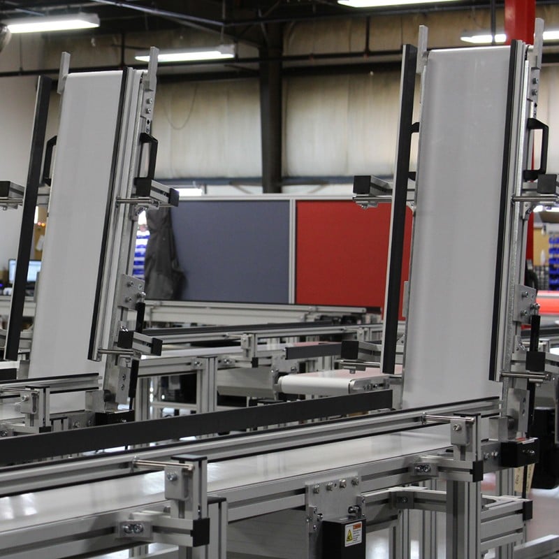

Has anyone ever implemented a lift gate conveyor in Visual Components? Something similar to these:
https://www.simplimatic.com/conveyors/lift-gate-conveyor/
If you wonder why I would want to replicate this feature, there are some lines where access is needed across the conveyor and no bridge is present. I want to model the disruption the lift gate creates.
If we don’t consider manually lifting the conveyor for now, it seems feasible with the current eCat, add servo controller to conveyor and some scripts.
