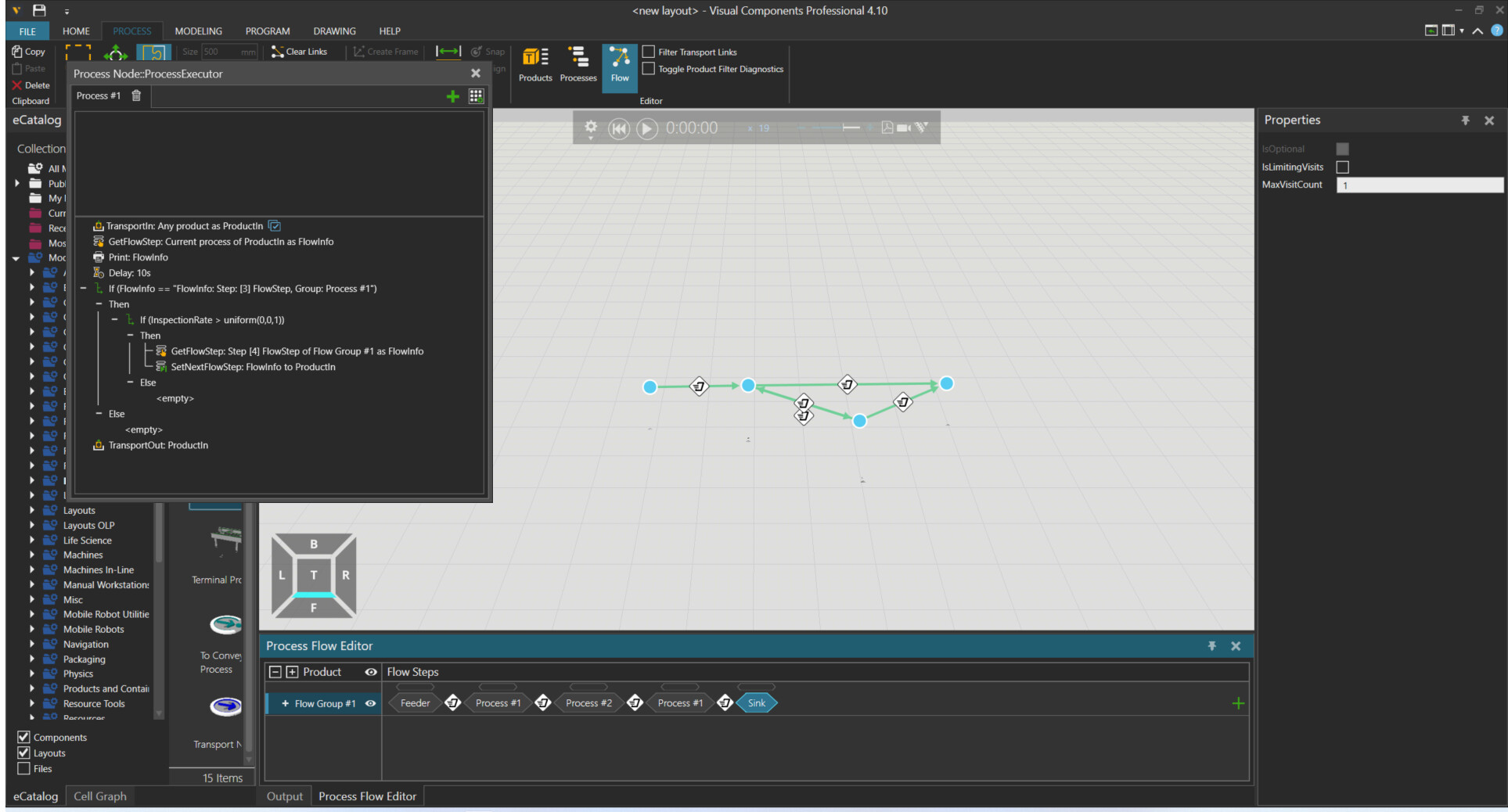

I am trying to have a statement check for if a part should be inspected only on a certain step in the flow group. The problem is that the same process has to be visited twice and I need the check to trigger on the second visit.
Is there a way to accomplish this using the flowsteps? When I tried the process below it never seemed to enter the first if statement.
