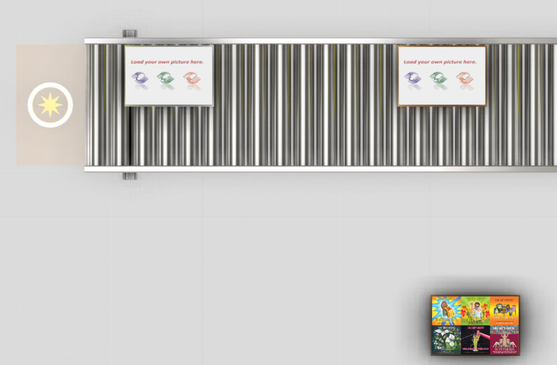

Can someone tell me if it is possible to have a part come out of a feeder with an image attached to it? I seem to have it somewhat working, except when the part come out, the image goes back to the default image (not the image I had selected).
I think it’s working fine, are you setting the ProductType first, and then the image URI? If so, then you will need to re-select it again to update the component (select the other component first, then select the target component, otherwise it won’t refresh)
Thanks for the quick reply, but I’m not sure what you mean when you say “Am I setting the ProductType first”. I created my part and placed the PicFrame on top and linked that to the image, then I attached everything together.
I selected it again and it now updated - seems to be working. Thanks for your help!
