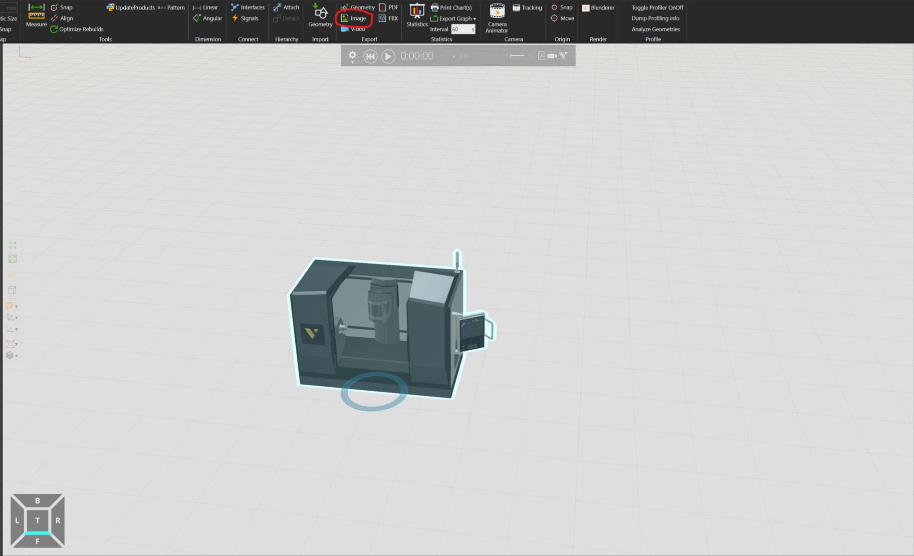

I have request for image export.
I am working on the project and need an image for individual facilities, not a full layout picture.
Is there a way to export only the shape of the selected facility from VC as shown in the attached picture?
All backgrounds except the photos of the facility should be deleted.

You can turn on the focus mode on the left side at the control panel. Then flip the unfocused opacity to 0.0. Now, only the selected components remain visible in your layout.
