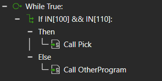

Hello, how can i program an if condition with 2 inputs and with logic gates?
“IN[1] and IN[2] == True” Like this? Or how?
Thanks in advance
Hello, yes you can!
Either like this:
Or you can use the Logic Gate component in the eCat - Misc
There is even a nice Layout Template called Logic Gate which could help you
