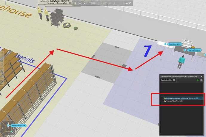

I’m creating a warehouse logistics simulation where a human resource with a shelf trolley moves between warehouse and workstations, delivering raw materials and collecting finished goods.
Each workstation contains a “buffer” for raw materials represented by the TransportPatternIn statement.
Mission contains steps with deliver_all set to true:
  "type": "Deliver",
  "scope": "Specific transport node",
  "transport_node": "Process Node - RawMaterialIn #1::TransportNode",
  "component": "Process Node - RawMaterialIn #1",
  "deliver_all": true
Issue: human picks up only 5 products (equal to the number of workstations) and delivers only 1 product to each TransportPatternIn, while actually it should pick 20 and deliver 4 to each.

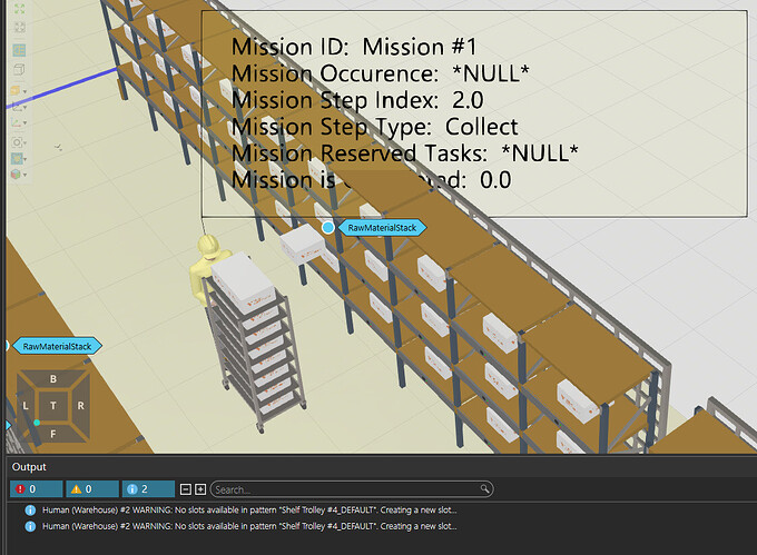

I found a solution for this issue, but ran into the opposite problem.
Solution: I switched the TransportPatternIn to Buffer and increased the ParallelInputLimit. Increasing this lets the resource insert more products at once.
The resource now fully fills all buffers. However, it’s not respecting the human’s transport capacity, “overloading” the trolley. The trolley is set to have a capacity of 16, but it keeps creating more slots.
0:01:59 | Info | Human (Warehouse) #2 WARNING: No slots available in pattern "Shelf Trolley #4_DEFAULT". Creating a new slot... | (2)
