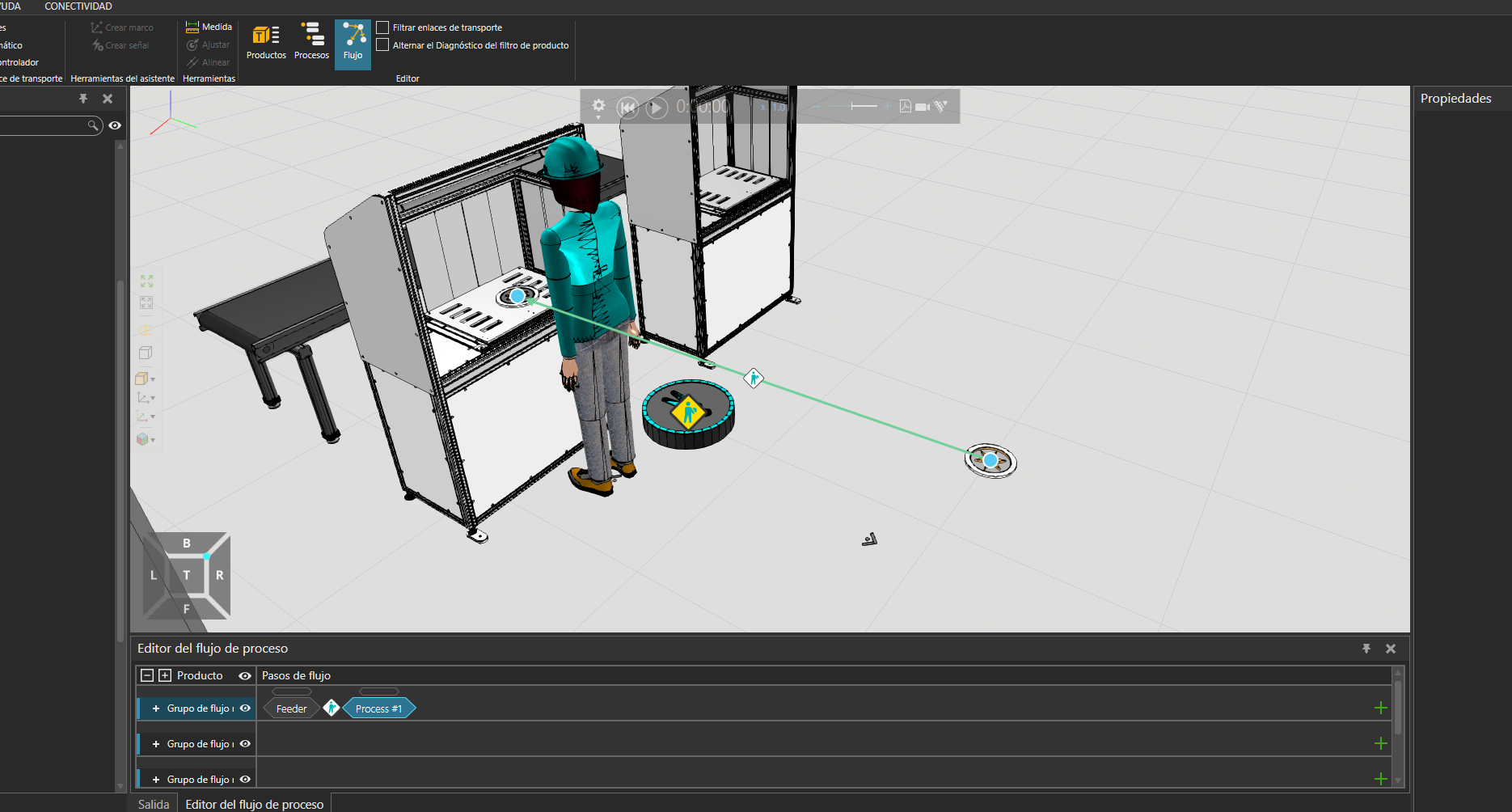

Hello, i’ve done this basic flow programing and i’ve connected the components but the humen doesn’t move, i want to pick it up and place it in the manual work station. What is wrong? Should i progam it like a robot? Or how?
Thanks in advance!
Thanks in advance!
it seems you have several Flow Groups, did you make sure that your Flow is in the correct Flow Group (the same as where the product created by the Feeder is)?
Otherwise, do you have errors in the Output?
