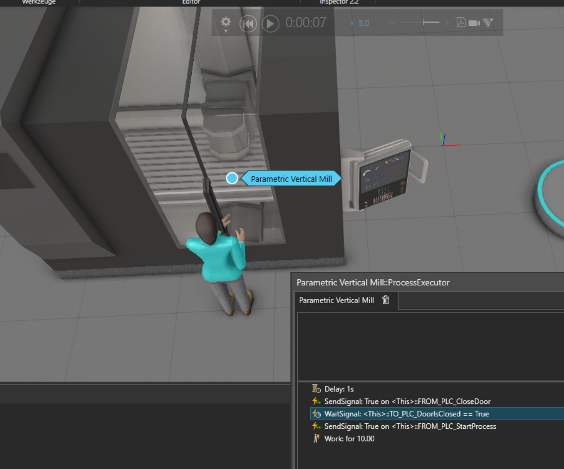

I have a person and a drilling machine. The machine has an executor and axes such as, the rotational movement is a handle and the translational movement is a drill that goes down to the workpiece. I want that when a person works on the machine, i.e. the command “work” is executed, the axes of the machine also move. Is there any way to implement this?
hi,
you can use signals before the work statement to execute work at the same time as the machine process
If your machine is self-modeled and already has a servo controller…
if not already done, then you can use the io wizard to generate input and output signals
