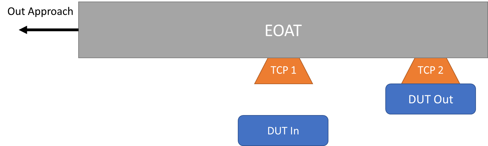

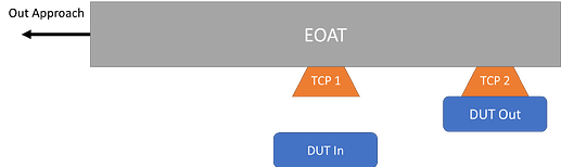

Does anyone know how to swap a TCP with a collection task just after a delivery task in Process Modeling, as shown below?

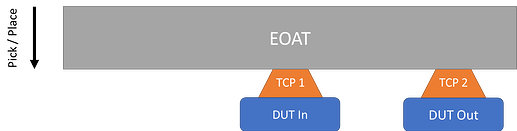

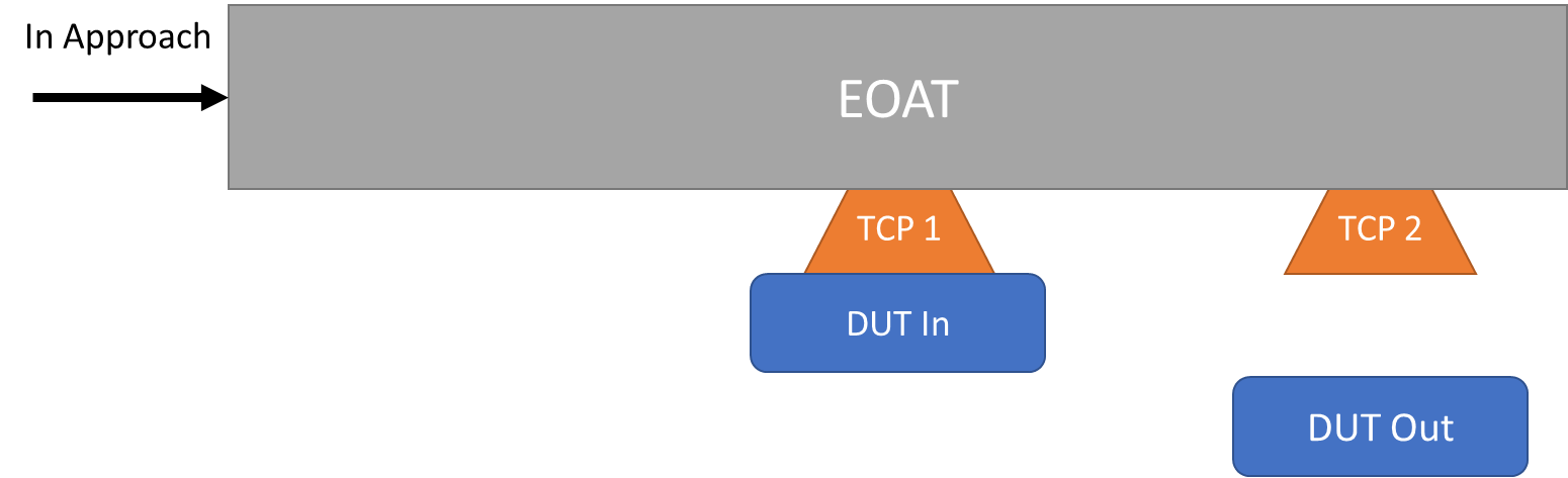

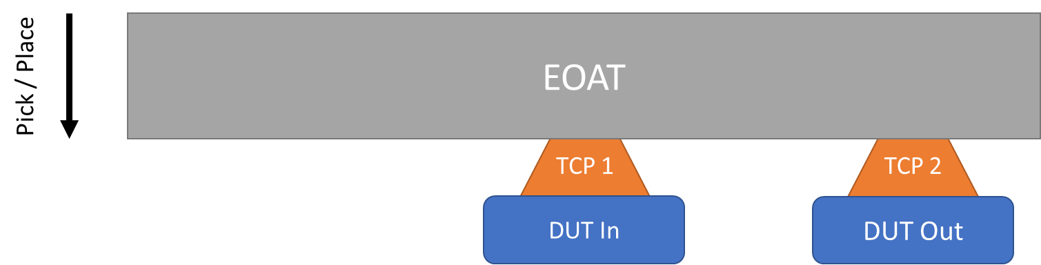

  • set your 2 TCP at the correct position

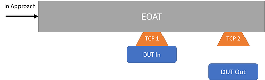

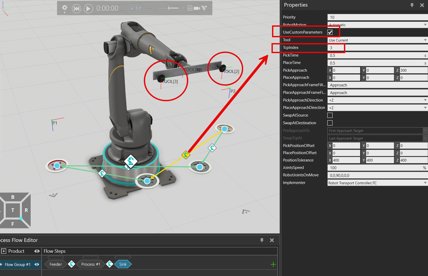

  • in the TransportLinks, enable “UseCustomParameters”, select the correct TCPIndex for each position and set the Place and Pick Approach to and from these positions to 0.
  • if the timing doesn’t match for both links you can add some signals
  • if you want to adapt it a bit more, you could try using the * Record-Execute Routine method
