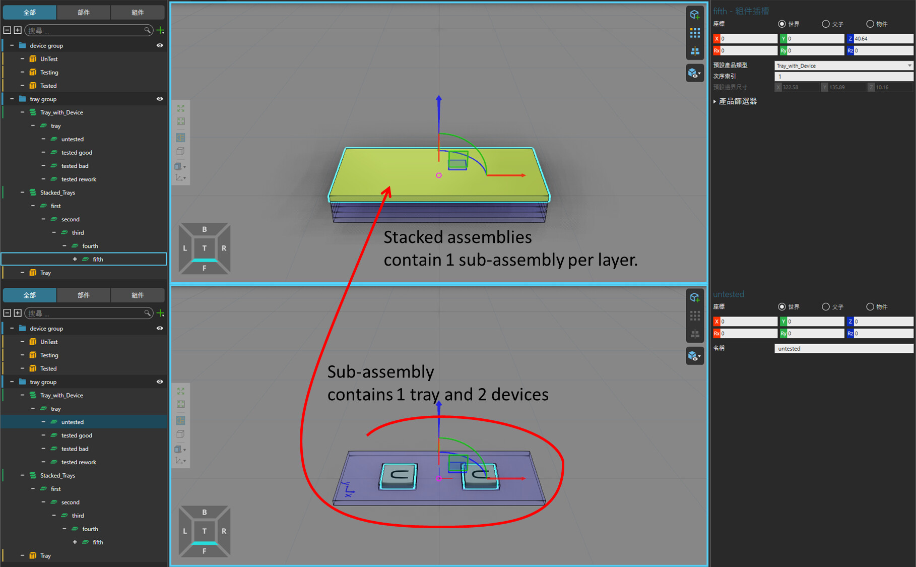

I’m encountering a problem with TransportOut when handling assemblies that contain other assembly.
The setup looks like this:

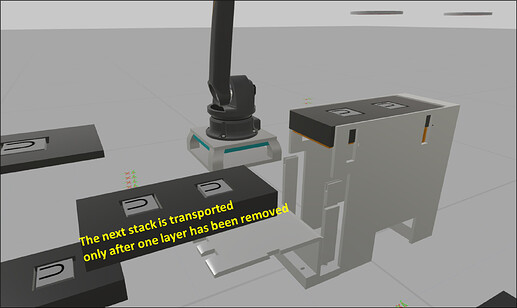

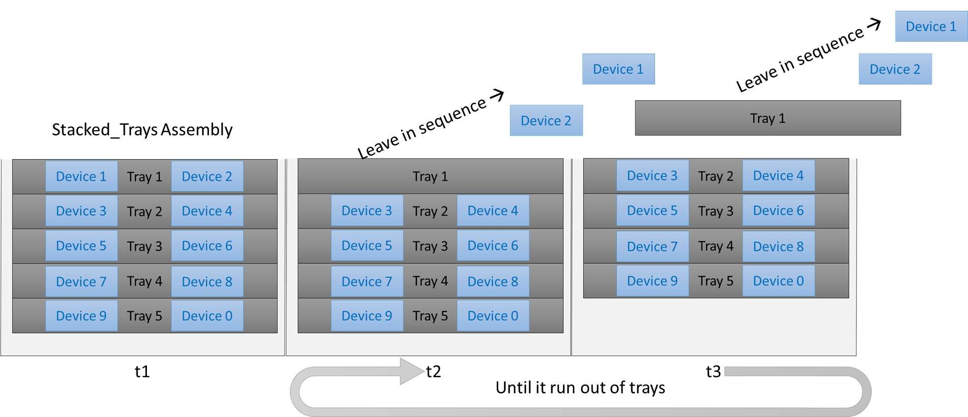

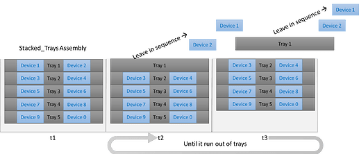

I want to transport out the stacked assemblies layer by layer, along with all the contents inside each layer.
Something like this:

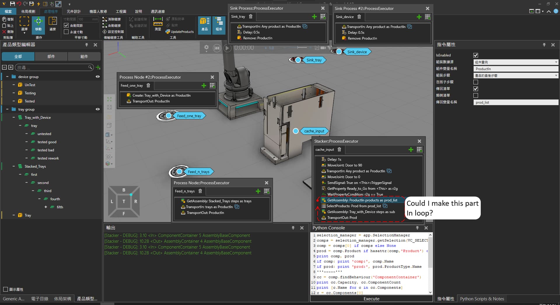

I tried using GetAssembly with ReturnAsList checked, and then applied SelectProducts to that list, so I could get the steps of the sub-assembly.

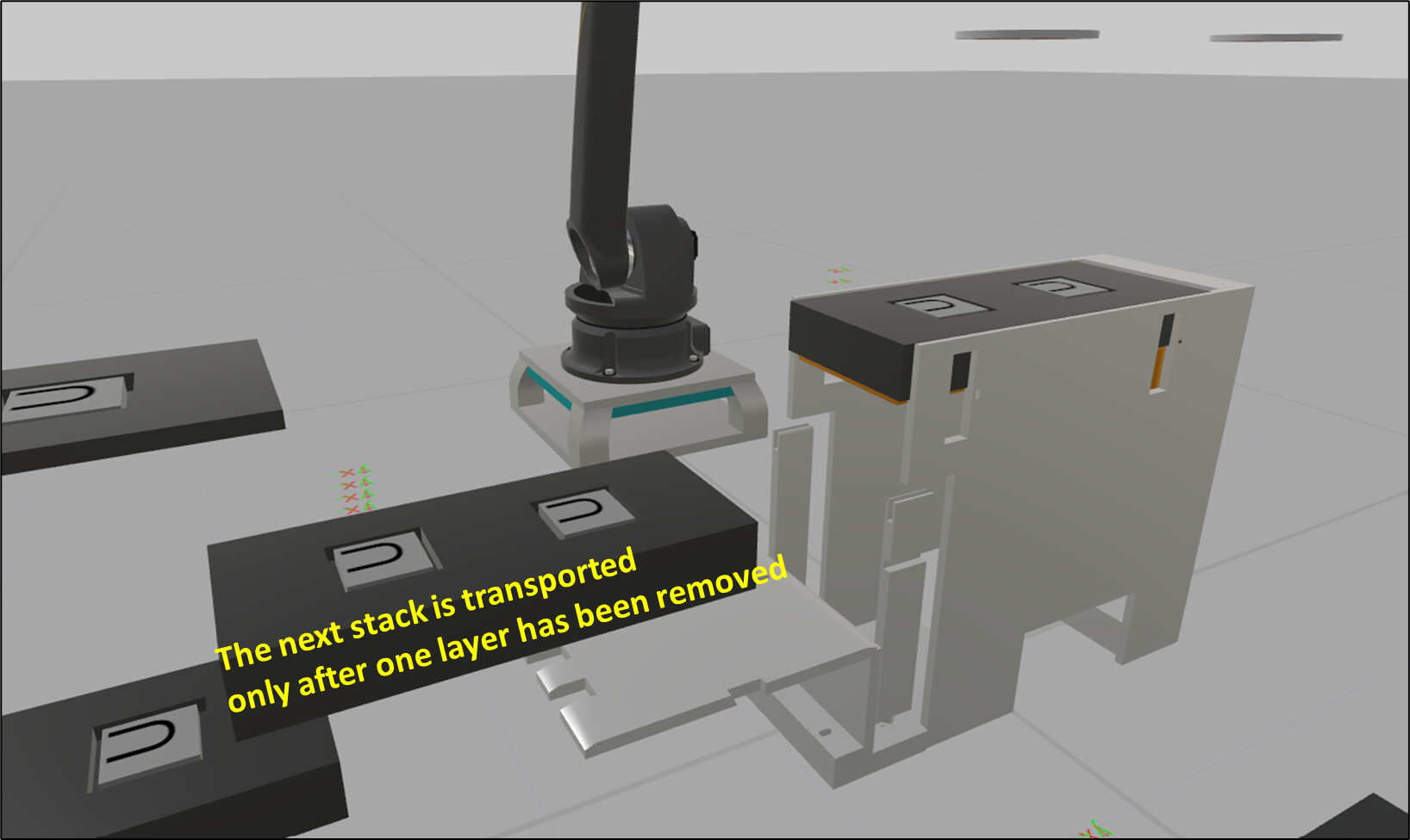

However, the next stack was transported only after one layer had been removed.

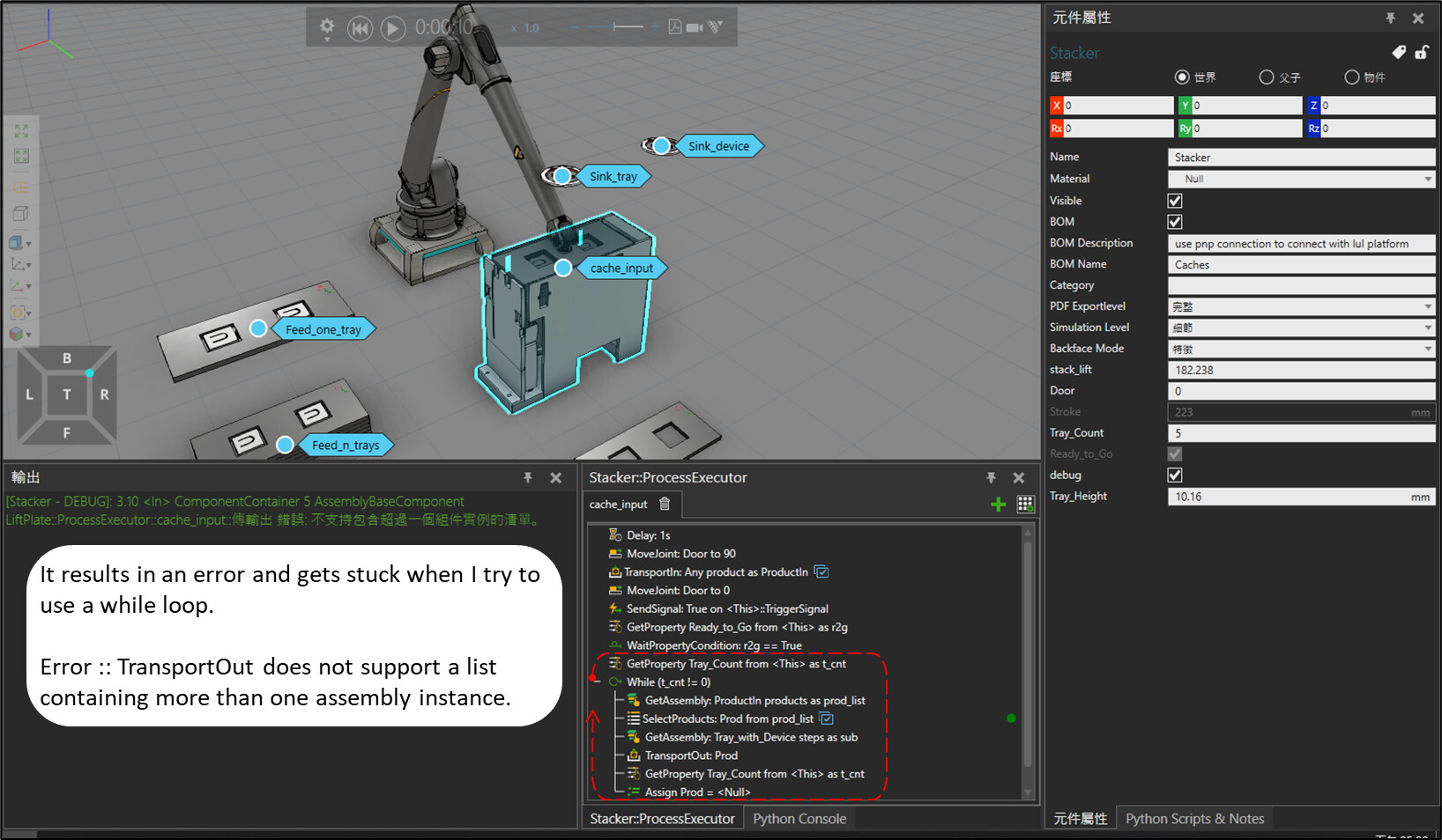

I also tried adding a while loop, but unfortunately, it resulted in the following error:
(TransportOut does not support a list containing more than one assembly instance.)
