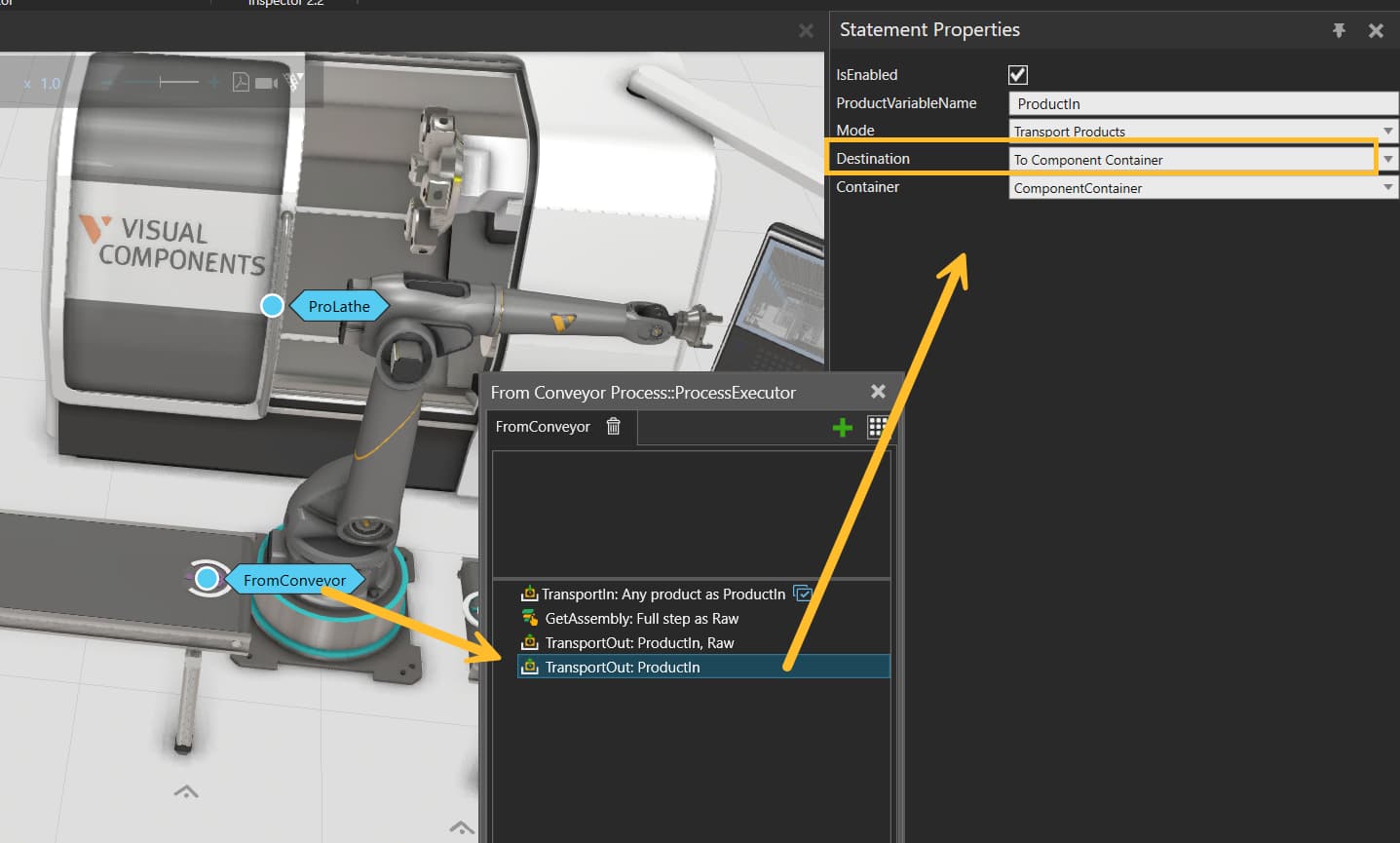

all your products are in the same Flow Group. So in the TransportOut, when the destination is set on “To next process”, it will look for a process where it can be transported, here the machine, like for the raw cylinders.
If you want it to just disappear at the end of the conveyor, you can set the TransportOut statements Destination on “To Component Container”, so that it continues on the conveyor, instead of looking for a process. You could also replace it with a Remove statement.
If you want the robot to transport the plate somewhere else, I would suggest to have the Raw product in one Flow Group and the Sheet + Assembly in another one, to configure the different flows.
