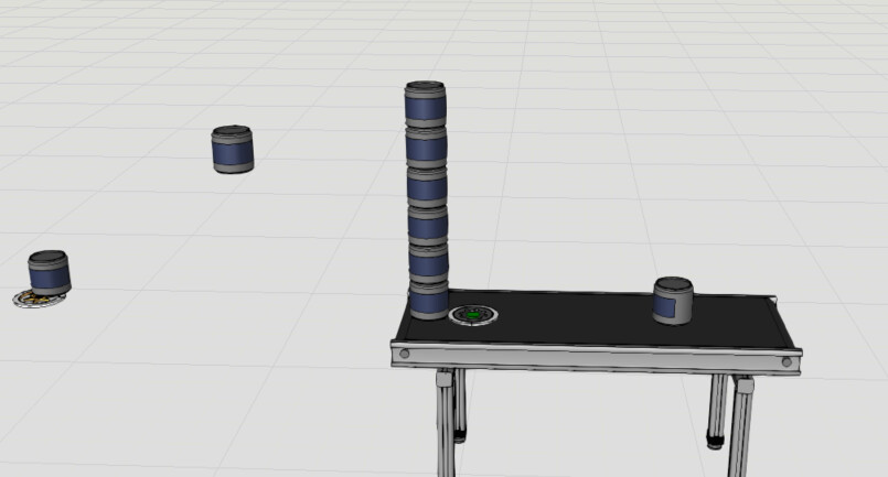

I am working on a project where i need to stack up 10 pieces of cylinders and release them one by one to the next process, starting with the bottom cylinder. I used Buffer Statement to stack them up but none of the cylinders travels out of the stack to the next node. Do you have any ideas on how to do that?

I made a quick test and the floorspace stack would work alright for this sort of case.
StackSample.vcmx (421.7 KB)
Hi Este, thank you so much, this is exactly what I need. I also learned many new things when I recreated your vcmx file. You just saved a life! :innocent:
