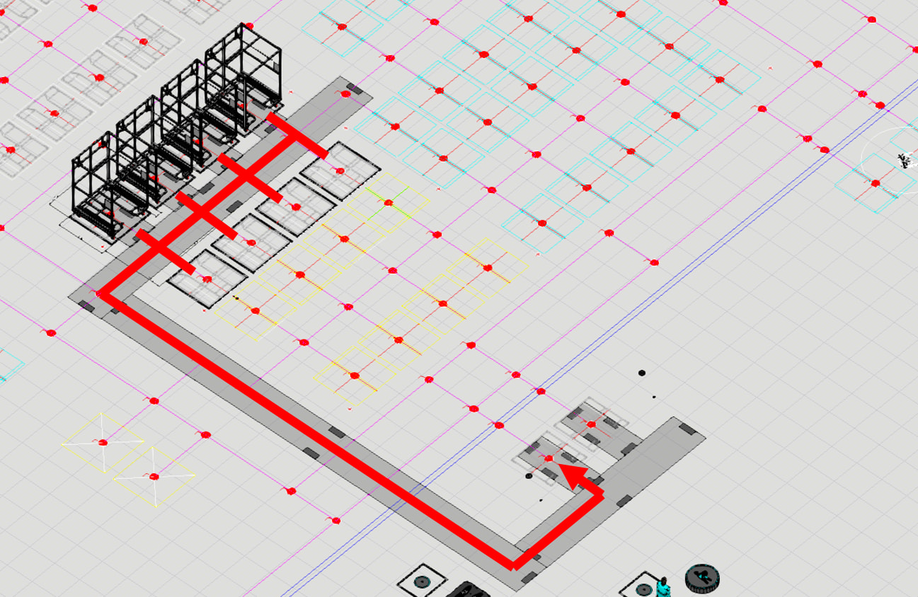

I am currently building a logistics simulation and ran into an issue.
I would like to move trolleys to the next node. When trolleys are created by a Feeder, I can select the Feeder’s node in the Flow tab and control the routing from there.
However, I already have trolleys positioned in the layout (not generated by a Feeder), and I cannot figure out how to recognize or control these trolleys in the Flow tab.
For the trolley waiting area, I am currently using the Floorspace Buffer component from the catalog.
How can I move or route trolleys that were not created by a Feeder?
Any advice would be greatly appreciated.
Thank you.
