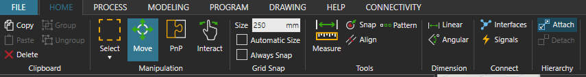

How can I attach to a component as a child?
I created a PlasticWrap and added it into my model, but when I save the model as a component and reopen it, the PlasticWrap does not appear in the saved component.
I attached the PlasticWrap as a child and saved it. when I save it again as a component and reopen, the PlasticWrap is no longer attached to the parent.
Which one of the components did you save?
-When you save the parent component (wrapper), child components are saved with it
-When you save the child component (wrap), parent component is not saved with it
Thank you, now its working
