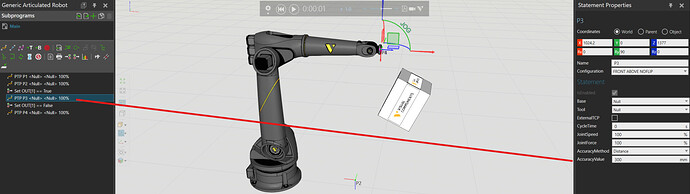

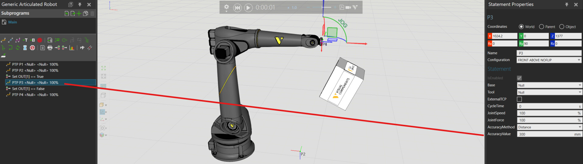

Have you tried to use the robot motion accuracy value to trigger the release command 150 mm before the target is reached?
You probably need to use some scripting trickery to force the position to the desired position if the default release location is not ok.

I haven’t tried using the robot motion accuracy value to trigger the release. Could you please give a simple example?
Thanks for this suggestion
AccuracySample.vcmx (610.0 KB)

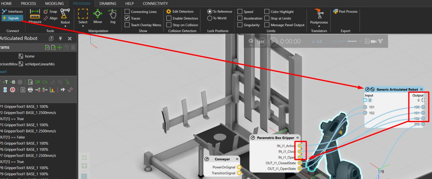

Also, when I use the GetProperty method, the gripper works fine — but when I control it through a program, the gripper does not release properly.

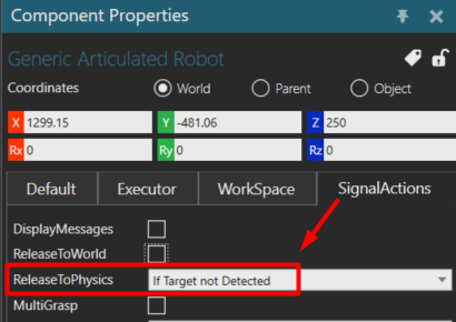

If you want the Boxes to fall, then you need to release them to Physics. There is a property on the robot for this.
As for the gripper, check the signal ports connected to it and set those signals to True/False. In this case, the signals are 100-102.
