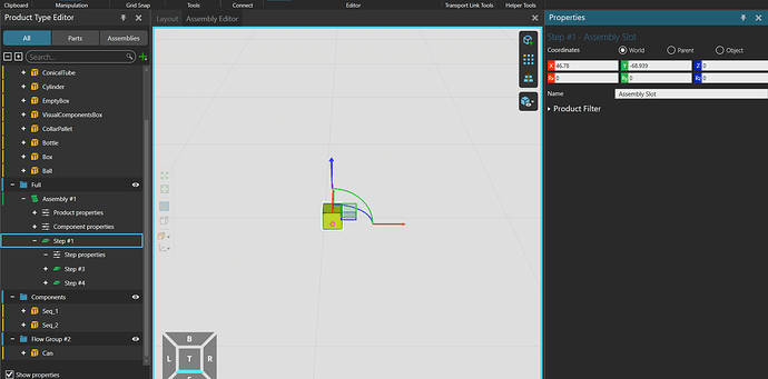

In the visual component 4.10, there is the interface that allow users to define the product type (see picture below)
But I updated it to 5.10, I couldn’t find where can I define/modify the type, could anyone tell me how to deal with this problem? Thank in advance!

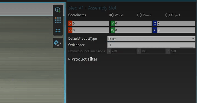

There is currently a bug with 5.1 version that has hidden these properties from the Assembly UI.
Right now assembly slots cannot be defined with 5.1, but hopefully a bug fix version is reeased soon.
As a workaround, you can set the default product type using Python.
In this example with Python 3.
ptm = world.ProcessController.ProductTypeManager
assembly = ptm.findProductType("PalletAssembly")
product = ptm.findProductType("Pallet")
assembly.Steps[0].Pattern.Slots[0].Item.DefaultProductType = product
