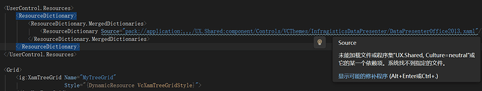

Sorry, I think for the “VcXamTreeGridStyle” style resource to be found and applied, its source needs to be added as merged dictionary in the parent control’s resources like this.
<UserControl x:Class="MyPlugin.MyPluginView"
			 xmlns:ig="http://infragistics.com/DataPresenter">
    <UserControl.Resources>
        <ResourceDictionary>
            <ResourceDictionary.MergedDictionaries>
                <ResourceDictionary Source="pack://application:,,,/UX.Shared;component/Controls/VCThemes/InfragisticsDataPresenter/DataPresenterOffice2013.xaml"/>
            </ResourceDictionary.MergedDictionaries>
        </ResourceDictionary>
    </UserControl.Resources>
	<Grid>
		<ig:XamTreeGrid Name="MyTreeGrid"
						Style="{DynamicResource VcXamTreeGridStyle}">
		</ig:XamTreeGrid>
	</Grid>
</UserControl>
Wow, thank you very much, it’s just like this style that helped me solve this problem! :+1: :+1: :+1:

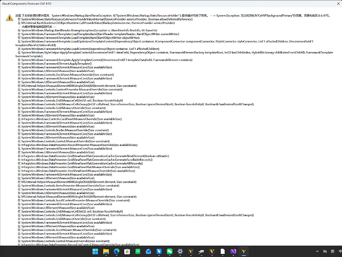

Hello, this code is throwing an error. The error message says the .xml file cannot be found. Is it because a required .dll reference is missing?
After Visual Studio reports no errors, this error occurs upon entering the VC software.
