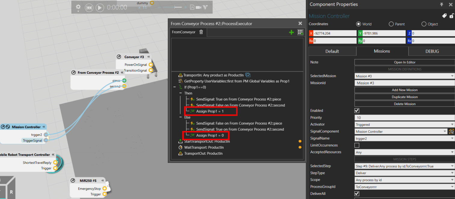

if I understand correctly, you are using a property from the component Global Variables to alternate between both triggers. But I haven’t seen anywhere where you change the value of this property.
If you use the Assign statement to change its value, then it will alternate each time :
