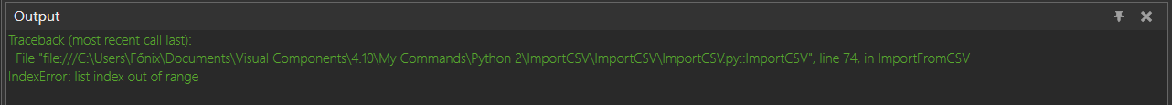

I tried to use this today with Visual Components Premium 4.10. With your example file (position.csv) it works, but not with my own.csv file. For some reason I got this error message:
Okay I solved it. I had an exported excel file, I used “save as” to make it, “.csv” and it used “;” as delimiter, while the python script was expecting “,” as delimiter, so I just replaced and it works just fine. (Okay almost fine. If I set 0 for base and tool it uses Base 1, and tool 1.) But it did the bigger part of the work so I’m happy.
