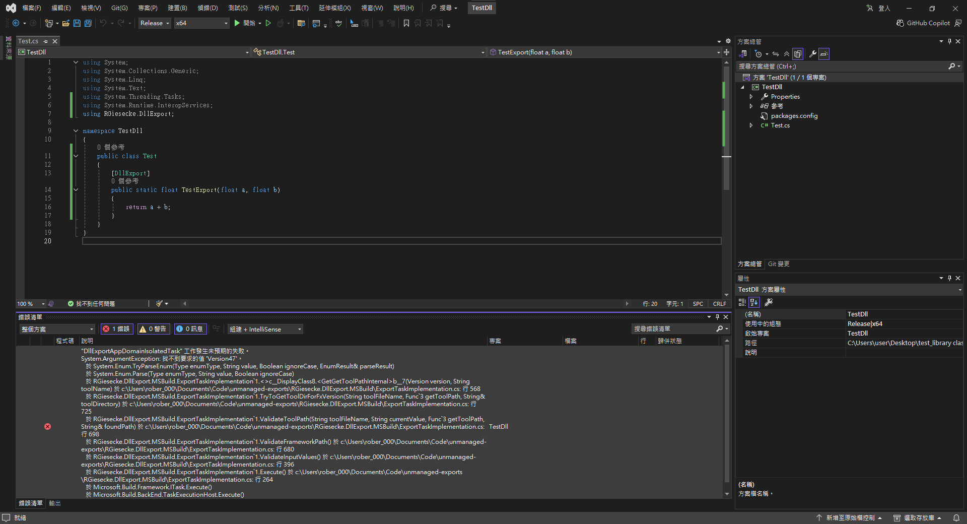

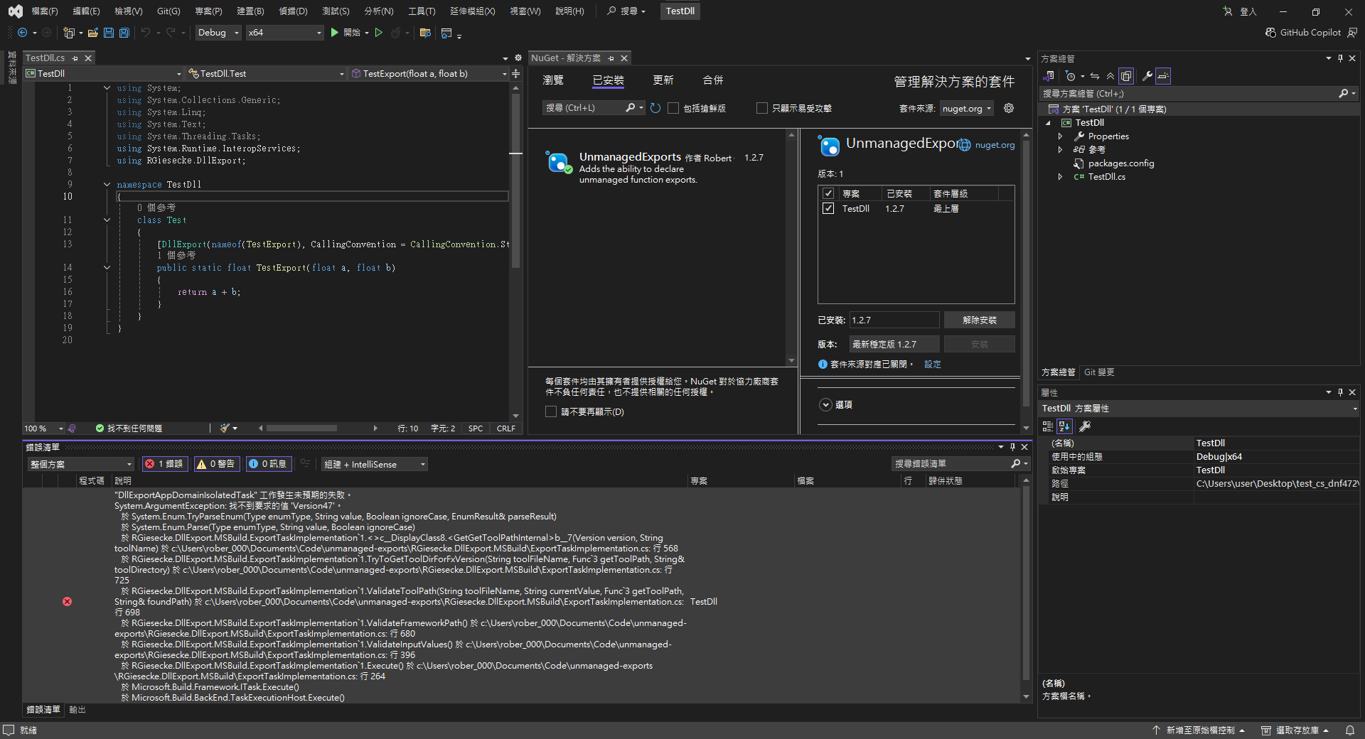

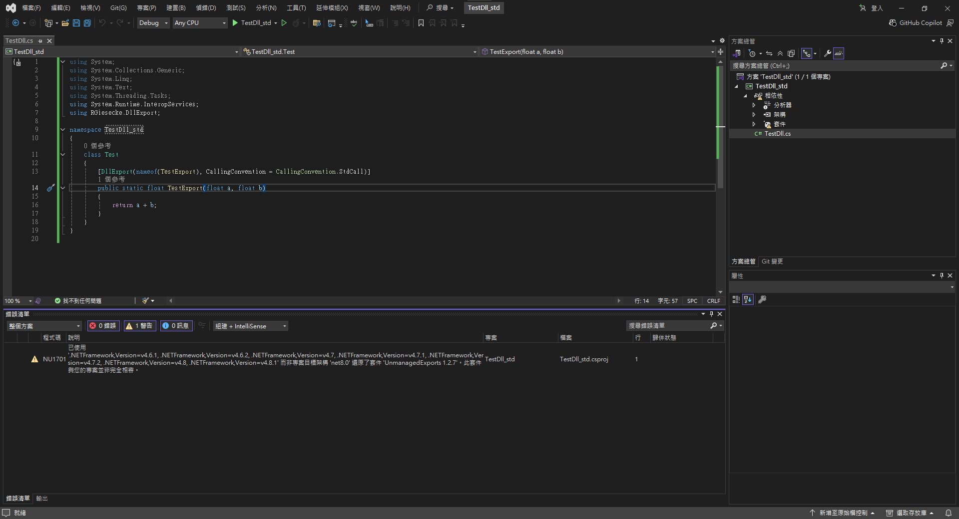

I opened a new Class Library using .NET Framework 4.7.2 (I wasn’t sure which version to use, so I went with the default suggestion) and added UnmanagedExports v1.2.7.
However, it failed and I got the following error messages:
Then, I tried creating a new Class Library with .NET Standard (.NET 8.0) and added the same UnmanagedExports v1.2.7. Although it showed a partial incompatibility warning, at least I was able to generate a .dll file:
However, VC still won’t accept it :disappointed_face: — it cannot find the function name, unlike what the author demonstrated.

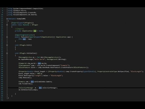

Can you test by adding “Plugin.” prefix to your dll name?
e.g. foo.dll –> Plugin.foo.dll
Please also see this academy video:

I tried your suggestion of renaming the file with the “Plugin” prefix, but it seems that was not the issue.
However, I was able to fix the DllExport unexpected error:
System.ArgumentException: Requested value 'Version47' was not found.
The solution was to install Microsoft Build Tools 2015, as mentioned here: (Failing to compile in VS 2017 · Issue #29 · 3F/DllExport)

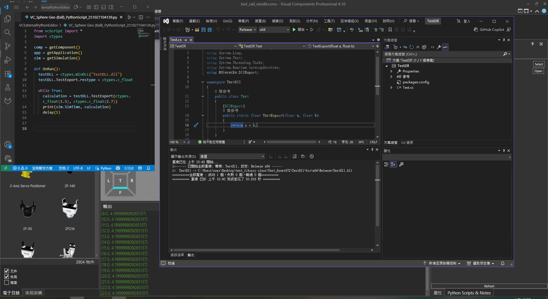

I think the problem was that I didn’t properly create an unmanaged DLL file.
Now, I can successfully import the DLL into a component using a Python script behavior.
