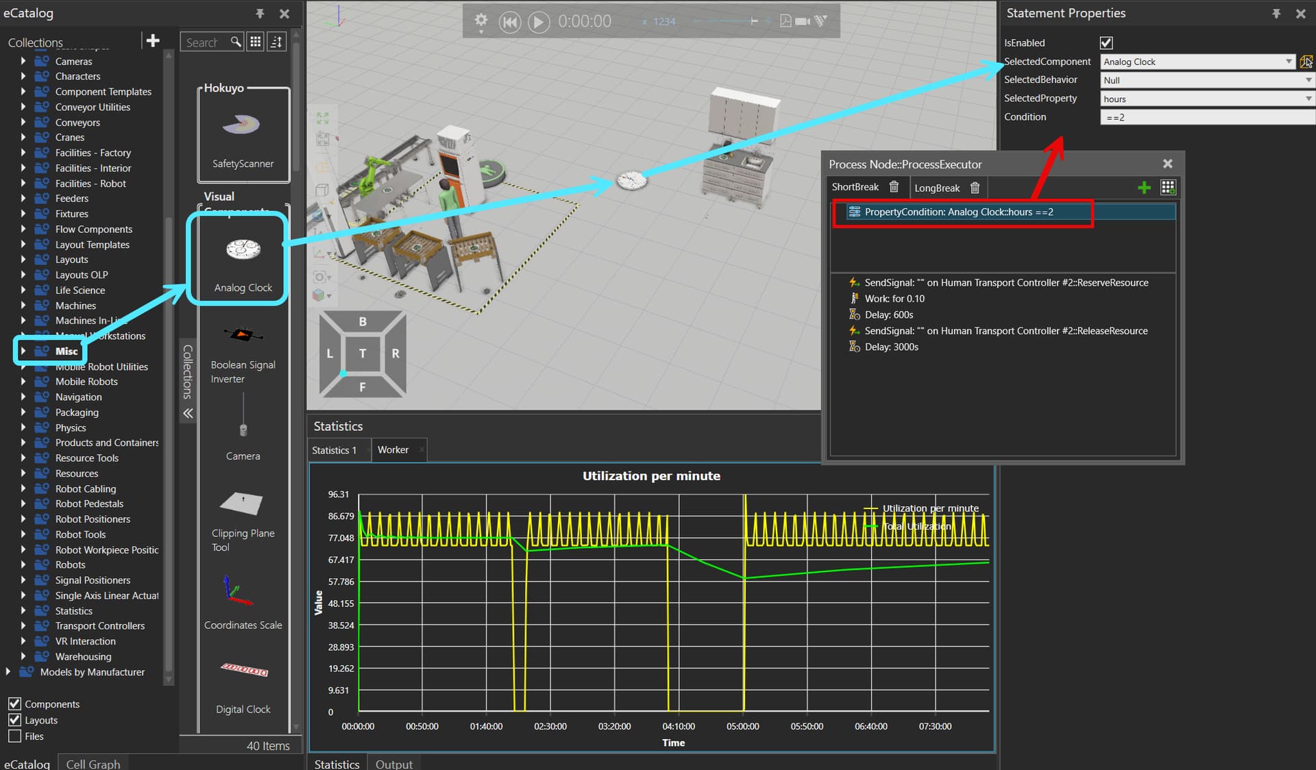

I made an example using the Analog Clock (from the Misc file in the eCat) to get the simulation time. You can then ask in your Property Condition, if the simulation time matches the break time:
BreakTime with PropertyCondition.vcmx (6.2 MB)
